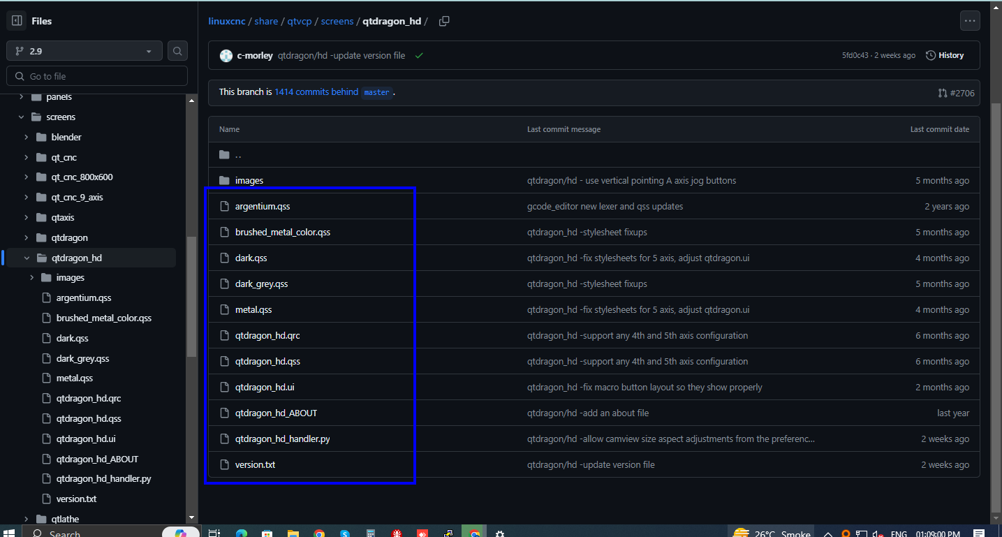

QtDragon_hd Qt Creator files was created by govind@89
Could you kindly provide a link to download the Qt Creator files specifically tailored for QtDragon_hd? I'm eager to obtain them for my project.
- Posts: 7368
- Thank you received: 2182
12 Feb 2024 00:58 #293133
Replied by cmorley on topic QtDragon_hd Qt Creator files
The designer .ui file is here:
github.com/LinuxCNC/linuxcnc/tree/2.9/sh.../screens/qtdragon_hd

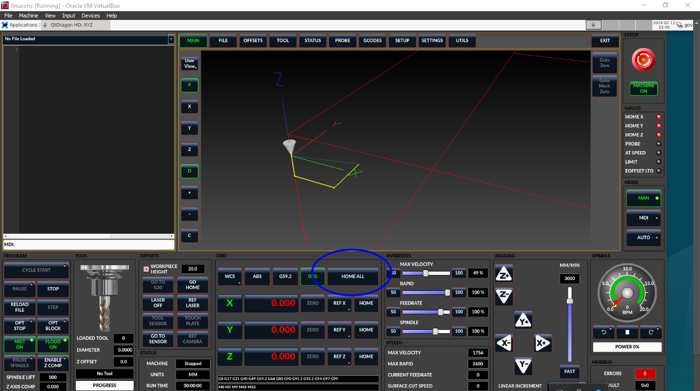

12 Feb 2024 07:59 #293149
Yes it can be customized in many ways.
Qt's Designer is the editor for the screen layout.
I use a text editor for the python code.
Here is documentation of the basic process:
linuxcnc.org/docs/stable/html/gui/qtvcp...._sheet_custom_screen
Home-all button calls the function btn_home_all_clicked() in the qtdragon_hd_handler.py file.
What is it you want to change?

12 Feb 2024 11:20 #293155
by govind@89
Replied by govind@89 on topic QtDragon_hd Qt Creator files
Thank you so much! I am thrilled to know that we can customize the GUI. I need to understand how GUI frontend to backend functions work and which functions are called to execute on those events and in which files.
Please guide me a few functions so that I can understand it better and make appropriate changes.
The ex.Home-all button calls the btn_home_all_clicked() function in the qtdragon_hd_handler.py file.

14 Feb 2024 02:16 #293301
This is the base folder for widget and libraries used in Qtvcp:
github.com/LinuxCNC/linuxcnc/tree/2.9/lib/python/qtvcp
Here is action buttons:
github.com/LinuxCNC/linuxcnc/blob/2.9/li...ets/action_button.py
This is the file that sends commands to linuxcnc (using the python linuxcnc module):
github.com/LinuxCNC/linuxcnc/blob/2.9/li...n/qtvcp/qt_action.py
