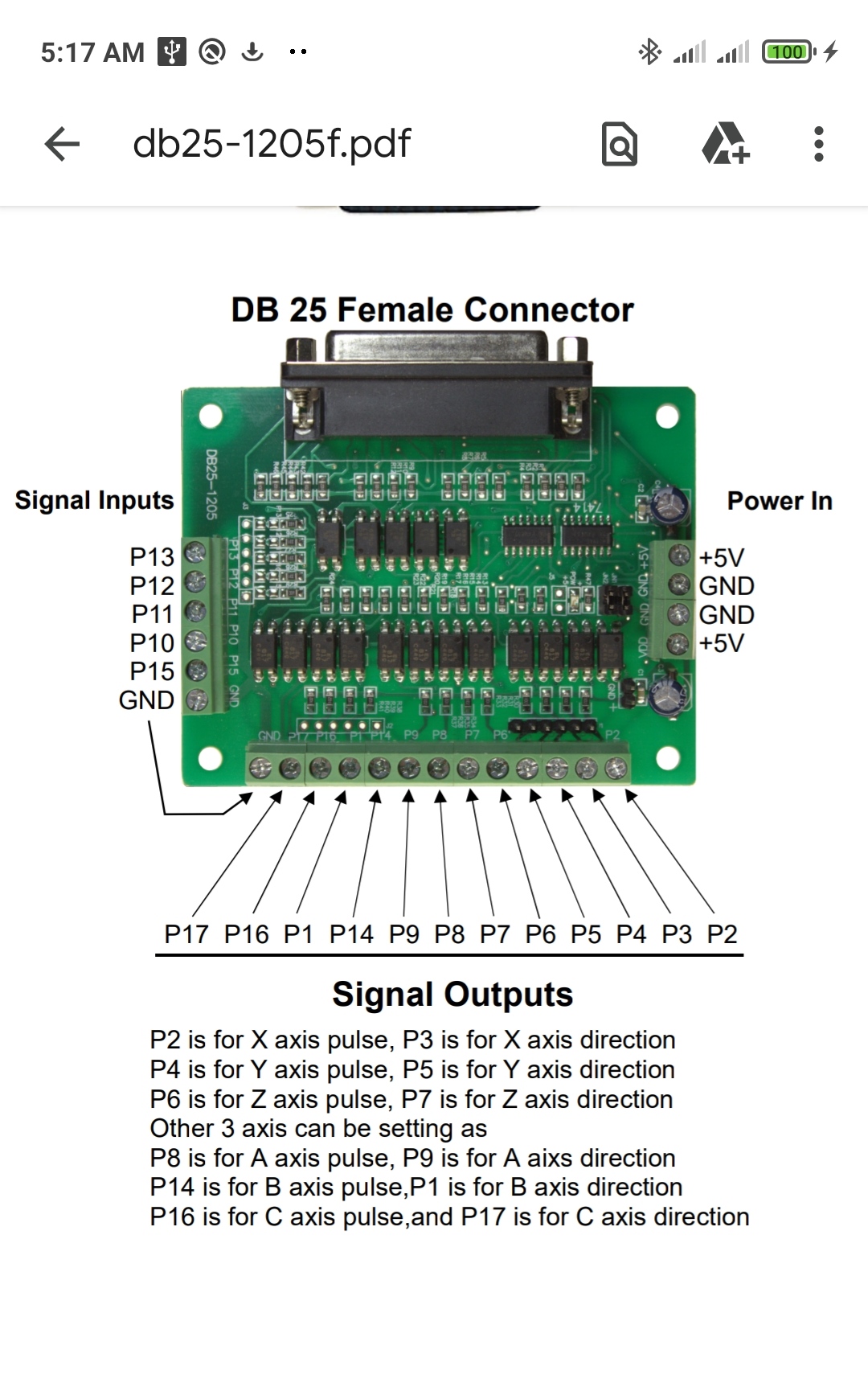

Start project with 6 axis Nema 17 stepper motors was created by noqui

Replied by tommylight on topic Start project with 6 axis Nema 17 stepper motors
Get the LinuxCNC ISO from the downloads page, write it to USB, boot the PC from it, install it to HDD, reboot.
Make a config for XYZA, wire drives to BOB (beware it does require 2 of 5V power supplies if you need isolation, only one if no isolation is required), see if stuff moves around.
Another thing to be aware of, the BOB uses really slow optocouplers, so might need to use a very slow base period, at least 100000.

Replied by noqui on topic Start project with 6 axis Nema 17 stepper motors
thanks tommylight for your quick answer, Few questions to understand you. 1) Why i must re install Linuxcnc if i have already install it? 2) What do you mean with BOB? Is it the B25-1205? 3) XYZA lets me control B & C stepper motors?
Sorry, i understood you that BOB is B25-1204, so forget about number 2 question. Number 3 question means can i add B & C steppers motors in XYZA? 4) as i need to use many pins, i think i must use 2 of 5v isolated. What do you think?

Replied by Aciera on topic Start project with 6 axis Nema 17 stepper motors
The installation description was added for completeness since it was not clear that you already have LinuxCNC installed, so disregard.
Use the PNCconf tool to create a configuration for a XYZA machine as it does not let you create a 6 axis configuration. You then need to modify the created hal and ini files to change the XYZA to XYZABC or whatever you need.
