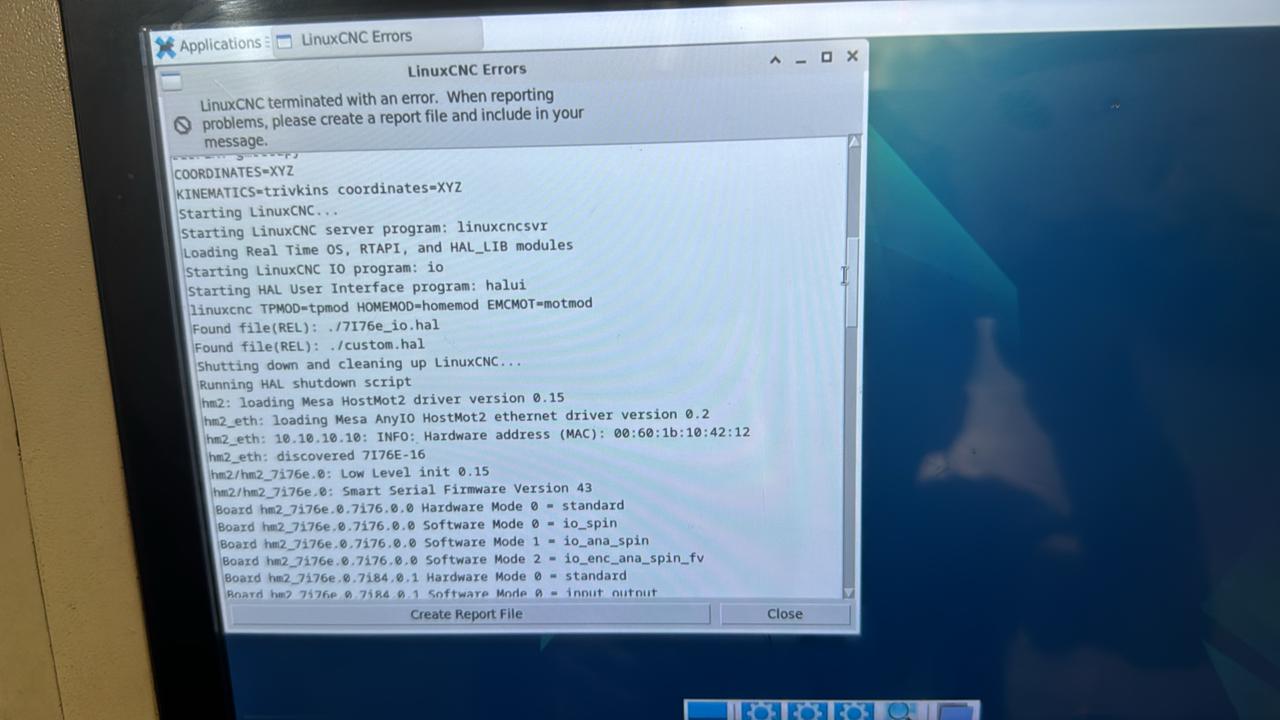

Facing Error after updating Linuxcnc to 2.9 from 2.7

Replied by Mecanix on topic Facing Error after updating Linuxcnc to 2.9 from 2.7
Everywhere you see axis.0. will need updating e.g. to axis.x.
Your INI file also need updating. For each axis you need:
[AXIS_X] and [JOINT_0]
[AXIS_Y] and [JOINT_1]
[AXIS_Z] and [JOINT_2]
All in all, you've prolly just discovered that you need a whole new set of config that rhyme with 2.9.

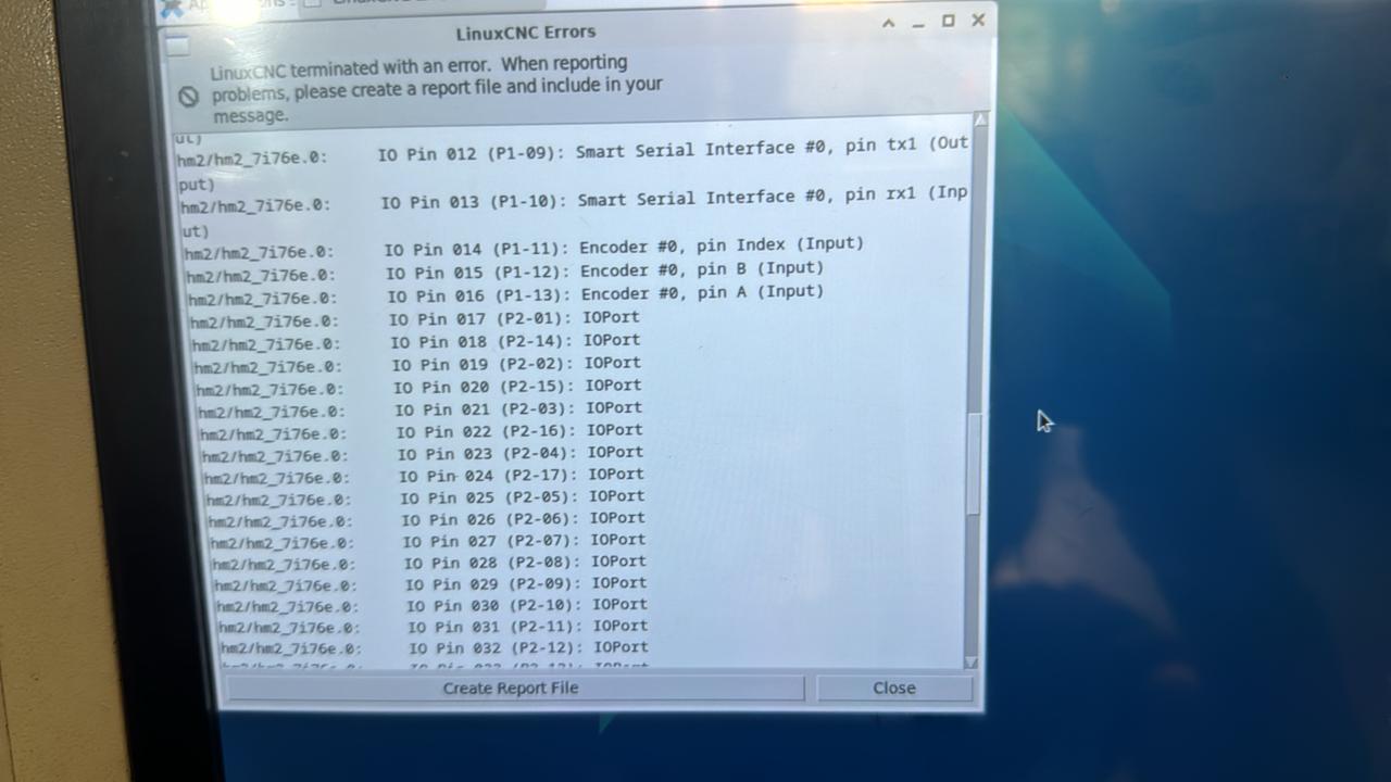

Replied by PCW on topic Facing Error after updating Linuxcnc to 2.9 from 2.7
The reported error is a syntax error in line 21 of custom,hal:
setp axis.0.jog-vel-mode 0
Which looks OK (at least in the supplied file)
Edit: as Mechanix suggested, this needs to have the axis letter
rather than number.
This should have been done by the conversion
script that automatically converts 2.7 configurations to 2.8+
It would be _much_ easier to identify the error by running LinuxCNC
from the command line and posting the printed text here.

- Posts: 18122
- Thank you received: 5337
28 Feb 2024 14:07 #294721
Easiest way is to launch LinuxCNC from the command line:

01 Mar 2024 00:29 #294821
by yrsiddhapura
Replied by yrsiddhapura on topic Facing Error after updating Linuxcnc to 2.9 from 2.7
@mechanix and @pcw thank you so much guys machine is working now
