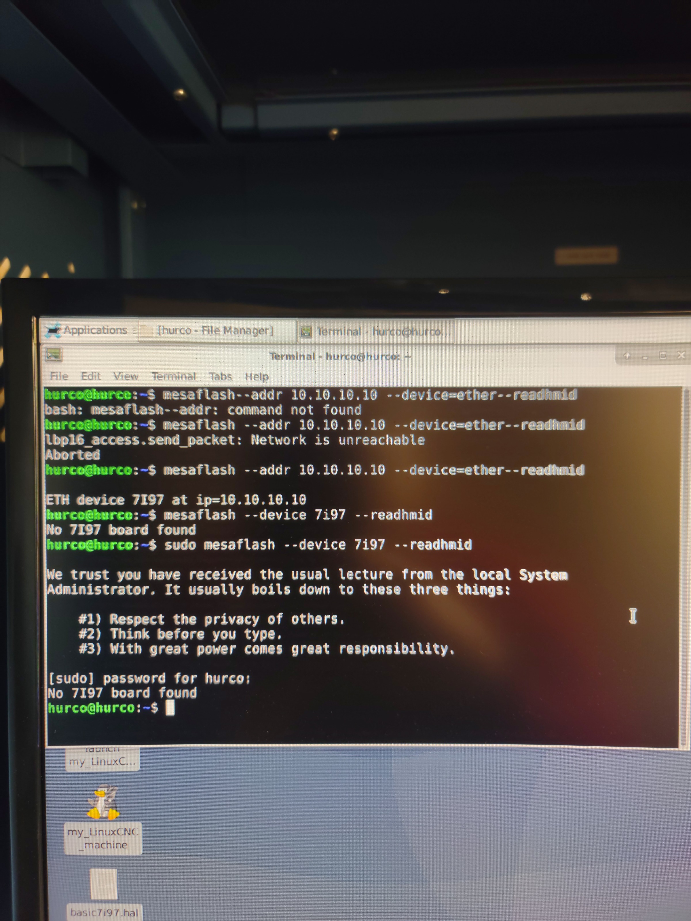

I just looked at the firmware through the terminal.
mesaflash --addr 10.10.10.10 --device=ether--readhmid
It returns ETH device 7i97 at ip=10.10.10.10
