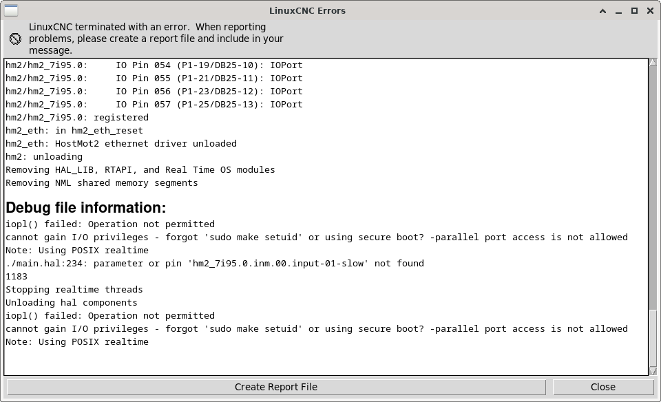

04 Mar 2024 12:49 - 04 Mar 2024 12:50 #295156
by slowpoke
When I attempt to start Axis, I'm greeted with the following error. (see attached)
I'm happy to do a bit of reading on hal to be less in the dark, there are numerous documents any suggestions on the best one for me to read or if there is something obvious from the debug information please advise.

04 Mar 2024 12:55 - 04 Mar 2024 12:56 #295158
Replied by PCW on topic Spindle control, three questions
Sorry forgot the 7I95 uses inmux not inm.
# load the flipflop component and add it to the servo thread
loadrt flipflop
addf flipflop.0 servo-thread
# we want the set/reset inputs to be slow and well filtered
setp hm2_7i95.0.inmux.00.input-01-slow true
setp hm2_7i95.0.inmux.00.input-02-slow true
# connect up the flip flop
net set-spindle-on hm2_7i95.0.inmux.00.input-01 flipflop.0.set
net set-spindle-off hm2_7i95.0.inmux.00.input-02 flipflop.0.reset
net spindle-on flipflop.0.out hm2_7i95.0.ssr.00.out-00
The permissions error is not related to this, that's often a LinuxCNC installation/build issue
