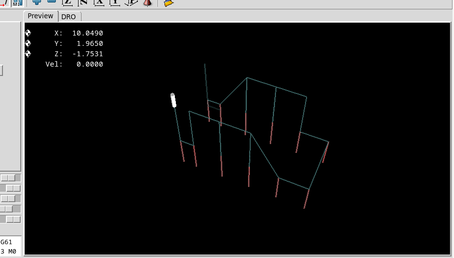

I am running version 2.8, attached code and an image. This is not the exact part, but the basic idea. There is a clamp between the middle two holes.
I need to go over the clamp. The issue is the diagonal path on the first and second jump to 2 inches.

What are you expecting instead of the diagonal paths?
If they are interfering with the fixtures then maybe this could do the trick (moves those two diagonal traverses away from the middle ) :

I expected a Z move to 2 inches before any X or Y move. Much as I get a Z move to .25 while in G99.
The issue is somewhat moot as the program is running in a Mazak and it behaves as expected.
I edited the program to just the single jump.
