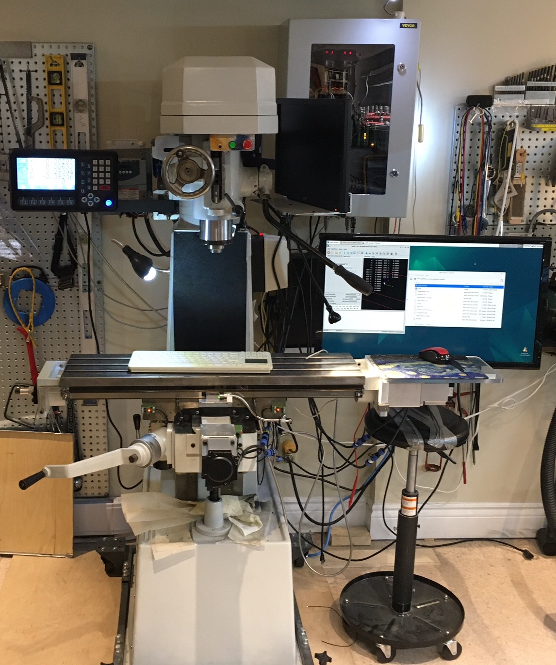

16 Mar 2024 13:01 - 16 Mar 2024 13:03 #296080
by slowpoke
Mill is a 1989 A1S knee mill, purchased used it was puke green and covered in grease but not sloppy at all, painted it silver-grey.
Replied by slowpoke on topic How easy for newbies?
@Slowpoke
Can I have some details of your machine and any photo to share here?

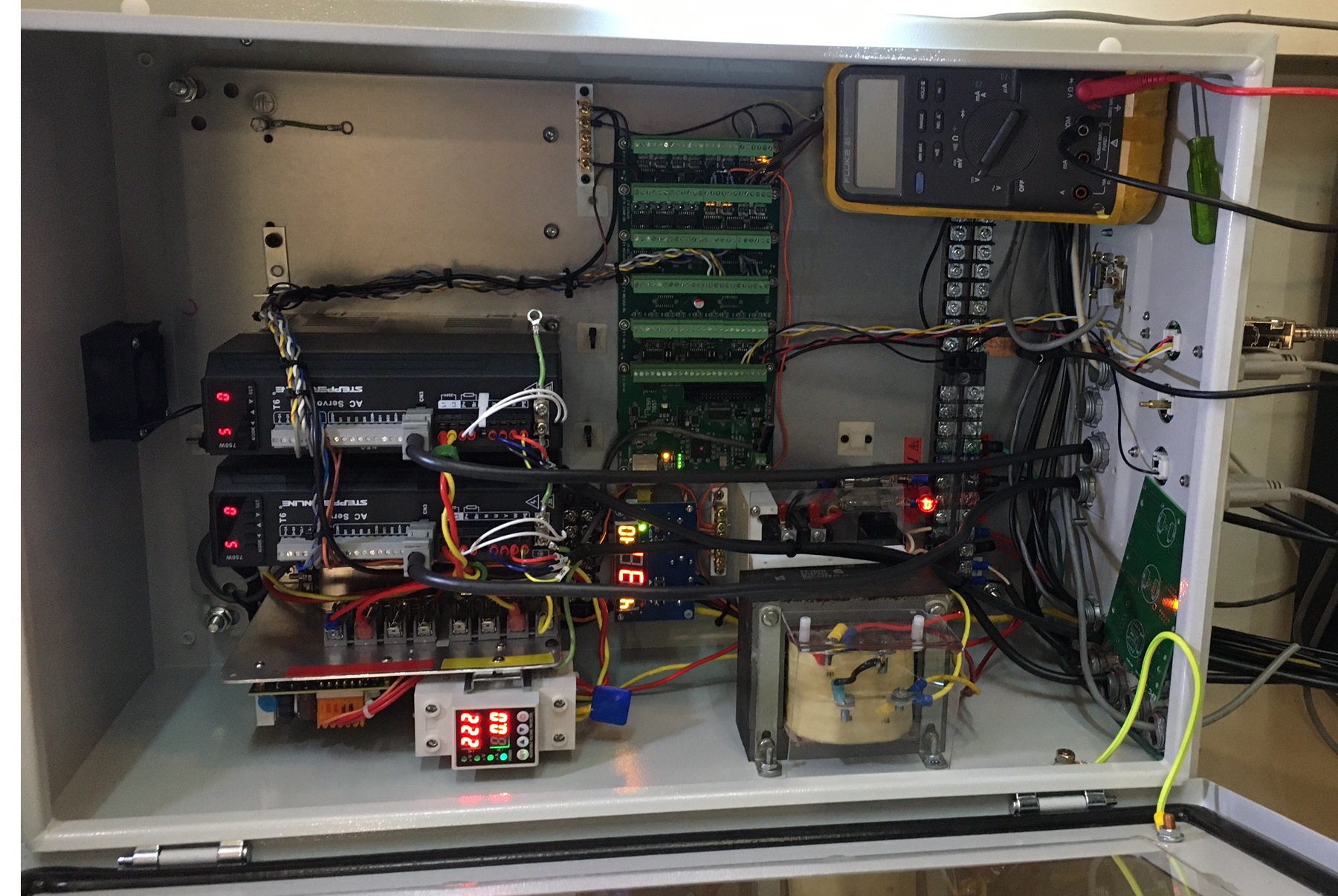

- Changed motor to 3-phase and added a VFD
- I replaced the leadscrews with ballscrews.
- Added: ac servos, linear scales. Ditron D80 DRO.
- Mesa 7i95t so I have room to grow, so far I have only installed drives for X and Y, so two more required for the quill and knee.
- Repacked the spindle bearings and was happy to find upgraded made in Germany angular bearings, run-out is now < 0.0002"
- Kijiji Vevor enclosure two for $50 so gave one to a friend and made a window in the one I'm using.
- Kijiji used HP PC $50 based on advice from Mesa
Last edit: 16 Mar 2024 13:03 by slowpoke.
The following user(s) said Thank You: tommylight, bharath12
- Posts: 22050
- Thank you received: 7509
16 Mar 2024 13:47 #296086
Replied by tommylight on topic How easy for newbies?
That chair has some stories to tell ...
Very nice, thank you.
