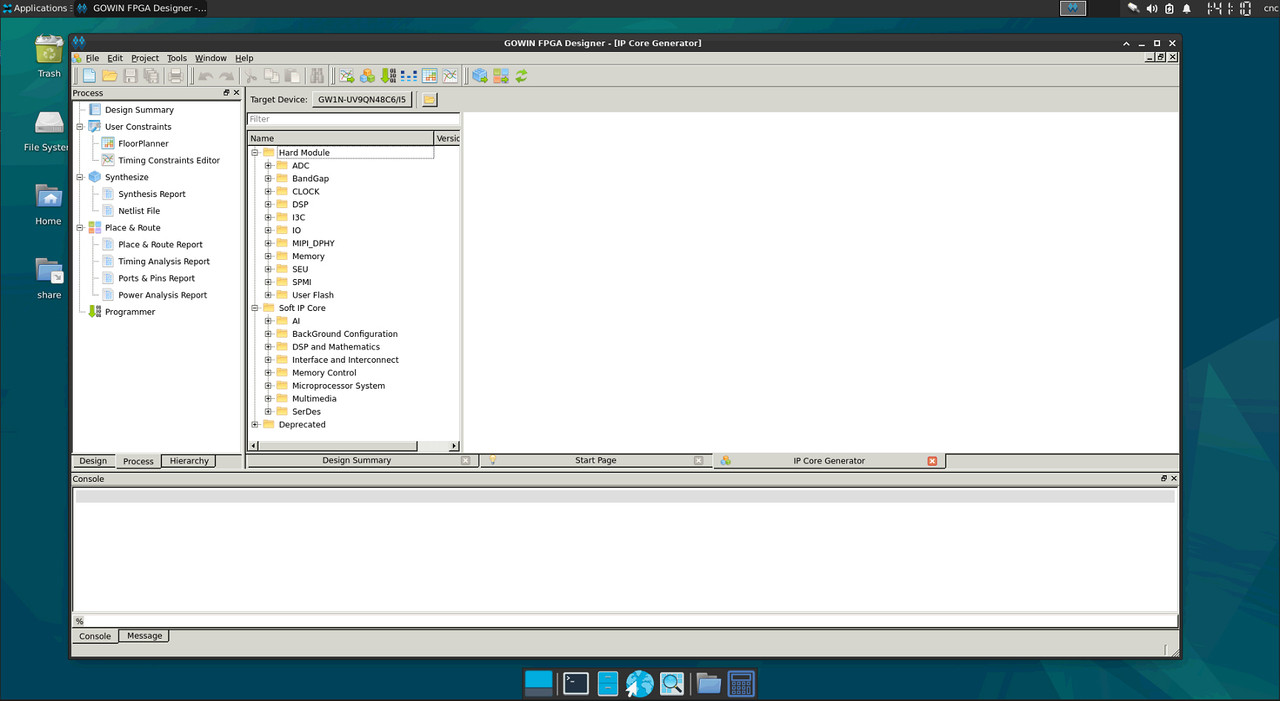

Spartans are killer, just not cheap anymore though (ironic). First functional project I made was on a spartan, a ov5640 door bell hack that was loool Got into the lattice during their debut, got whacked out from their free license, since moved to the M3 hard core + FPGA fabric "all-in-one-silicon" (GW1N, from Gowin). Check'em out, some seriouzpwr for a few bucks (search keyword "minimal schematic" in their doc center for putting up a dev board in 2hrs).

No fancy 15million gigabytes bs vivado dwloads required. Cortex core part can be written in eclipse/keil/whatever (for those of you familiar with MCU c/cpp), and the hdl's carried using their designer. Easiest, cleanest, fastest and most efficient free licensed IDE I know of. /A f f o r d a b l e, and it just freaking works. Raspi... [rolleyes], come on now @OP...
