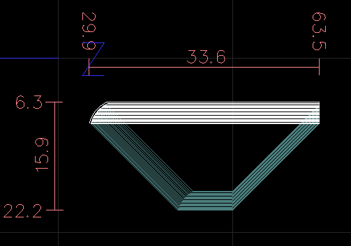

The reason G70 gives you a different path is because G71.1 does not cut pockets while G70 does. So in essence G70 actually cuts the path in the subroutine.
If you add a G71.2 to your program:
You can see the actual profile the subroutine creates.

As for the arc move:
You're telling the controller to find a counter clock wise arc with radius (r.1875) from point (X 0.25 Z1.5), which is the endpoint of your G1 move, to point (x.3750 z1.1768), which is the endpoint of your G2 move. The only way to do this is the arc you see in your original post that cuts a pocket. If you want to avoid cutting a pocket with an arc of the given radius you need to move the endpoint of your G1 move closer to the end point of the arc.
The point I chose (X 0.25 Z1.28) is the other intersection of your G1 move with the arc of your original code since I thought that the geometry might be important to you, but other points are also possible of course. Often we would want the arc to be tangential on the final geometry.

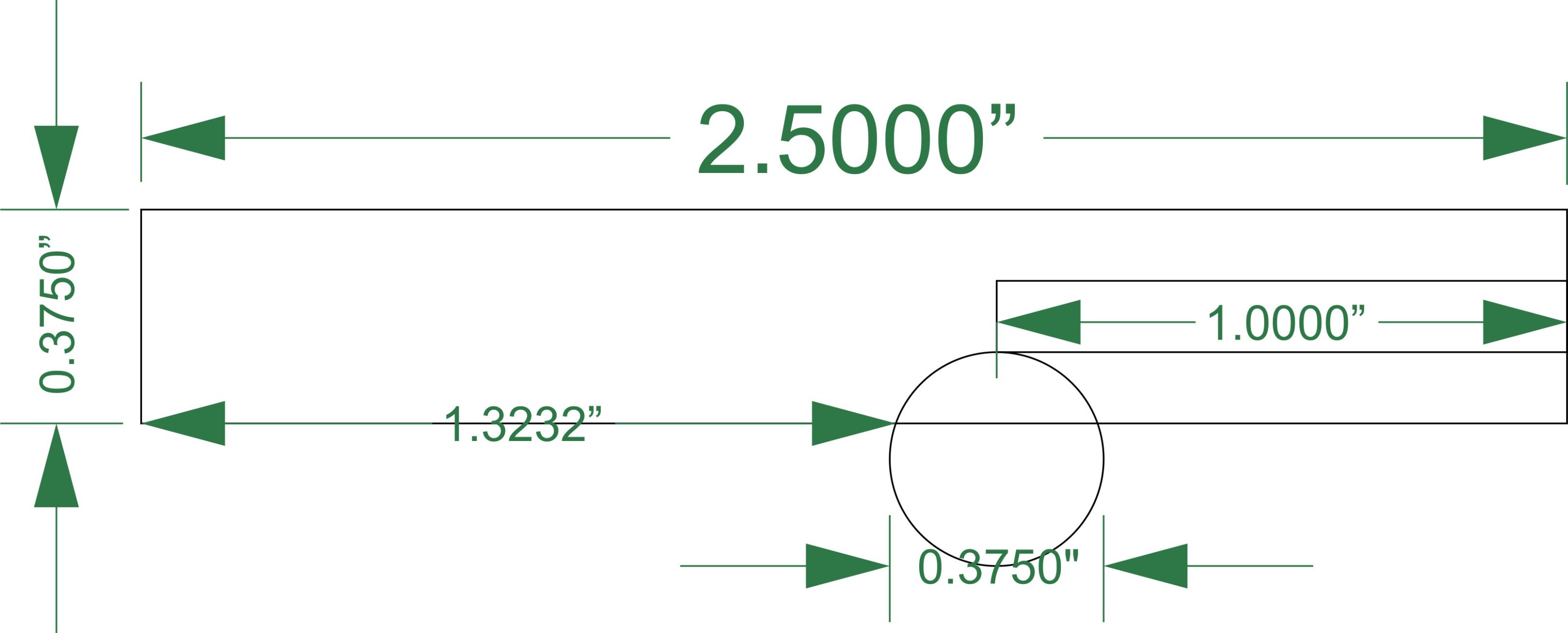

I've always used // to comment out code lines, I didn't realize ; had that function. Seems like there was another one I used early on, lots of options. The 1" long skinny section was the critical dimension, the curve out is just reinforcement and a place to lay the user's thumb, it's a basic low-pressure wire insertion tool. The only thing I can't quite get a handle on is the precise locating of the 1.28 dimension. In my drawing, the arc ends at 1.3232, so I'm not quite clear on arc placement in this application. I'll see if I can upload a pic that shows my drawing, I'm guessing LINUXCNC sees the arc a little differently because that number won't work. I know I'm not looking at placement correctly from the software viewpoint because of that divot, just not sure where my error is. Since most of my use cases will involve starting and ending arcs from a line, I'm hoping for that "aha" statement
I've tried a number of ways to work this out on my own, just not seeing my error.
