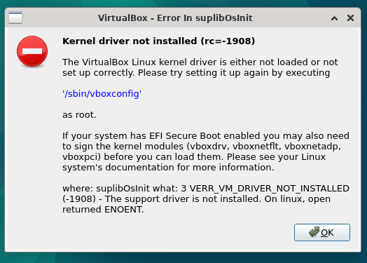

Hi
I have been trying to install the new version of linuxcnc. Never had any problems with the older versions going back to ubuntu 8.04.

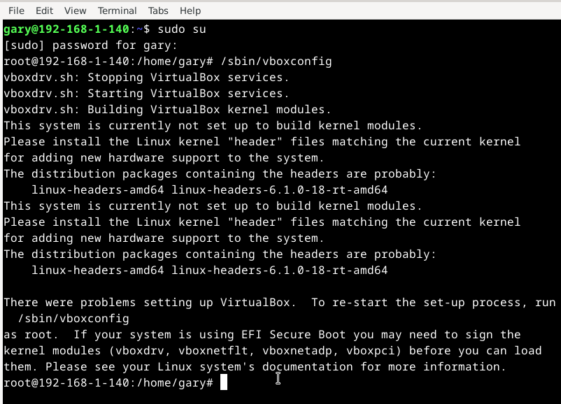

I always have been able to install virtualbox on any of the systems in between. This being the case I went about it in another way. I install debian 12 as an alone standing base system and added virtualbox in the usual way. Worked like a charm. Now came the crunch, I installed the rt kernel. As soon as I restated with the new kernel this came up. See attachment.
How can this be rectified? Restarted the computer with the original kernel. No problem. Also tried to run /sbin/vboxconfig in sudo su. it just regurgitates what happened when I start Vbox. and Terminal output sbin vboxconfig Screenshot_2024-03-21_15-48-24.png
I run windows 7 in virtualbox so I can use aspire to fix up any small irrigularities in any files without having to break work
I'm running on my cnc mill The workshop is a good 100 meters from my home, can't run up and down all the time.
Thanks in advance.
Gary
ps. This is a brand new linuxcnc setup.

UEFI does not allow changes to the kernel module so this is not actually a linuxcnc issue, just the way the world is going.
If you are unable to disable UEFI in your BIOS, you will need to create a MOK (Machine Owner Key) and install it for the modules it refers to
Google search: linux uefi signing module
Debian: wiki.debian.org/SecureBoot
I did do some very brief instructions in a spoiler in this thread for installing ethercat forum.linuxcnc.org/ethercat/45336-etherc...-how-to-step-by-step
