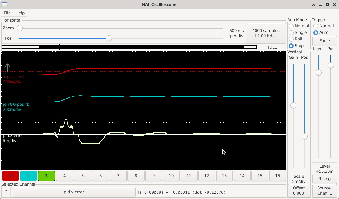

Focus is on X axis, if I can get that sorted should be easy to implement the other joints.
System:
Ditron linear scales feeding both a Ditron DRO and encoder 0 on Mesa 7i95t.
ac servo that has integrated encoder feeding back to ac servo driver hardware, So I could also tune the ac servos PID parameters, however when operating in LinuxCNC open loop mode the ac servo settings are behaving rather well. Fast, no hunting basically perfect except ballscrew error of about 0.005" that is easily measured between external DRO displayed value vs. value in Axis.
Update on backlash: I created two near identical versions (one open loop with backlash compensation) and the other closed loop. The open loop with compensation is actually quite accurate. With backlash compensation enabled in the the closed loop version it actually makes things much worse and introduces an error of the backlash value on each move, so interesting but not helping.
Using tommylights as well as Hakan's zx45 hal and ini examples I now have my system operating closed loop.
With high vales of P(1000) my system hunts excessively, as I decrease P; 400,200,100,50,25,10, 5 the hunting goes from pretty wild to barely perceivable with error oscillating very slowly (a few tenths over 2 seconds). Sometimes it undershoots an other times it overshoots and then corrects.
I have no experience tuning PID loops other than using the self tuning feature for the ac servos which seemed to work however I learned little during the process.
I have attached my .ini and hal files
Advice please.

You must decide what PID is the master.
In open loop is P1000 normal value in linuxcnc ini. In closed loop you should start with P1 and go slowly higher.
Quick and dirty guide -> If your axis starts to oscillating, decrease P 10%. You could also try to add a deadband value.
Next step cut a circle and if round good job.
Other idea is to decrease the PID in Servodrive and increase P in linuxcnc. High end tune is to look in halshow how close command and feedback position together.
But this need much time, much coffee and little luck.

Replied by tommylight on topic I have closed the loop, need a little help with PID tuning
FF1 is still 1 in the ini file, chances are that will not be correct for almost any machine with normal output scaling, so have a play with some values, start from 0.1 increments, watch the f-error on the scope if it gets bigger or smaller after a change, if lower, try smaller increments, example 0.3 makes the least f-error so try 2.5 and 3.5, again example 2.5 has lower f-error and we know 0.3 is better than 0.2 then it must be between those values, so try 2.6, 2.7 etc.
