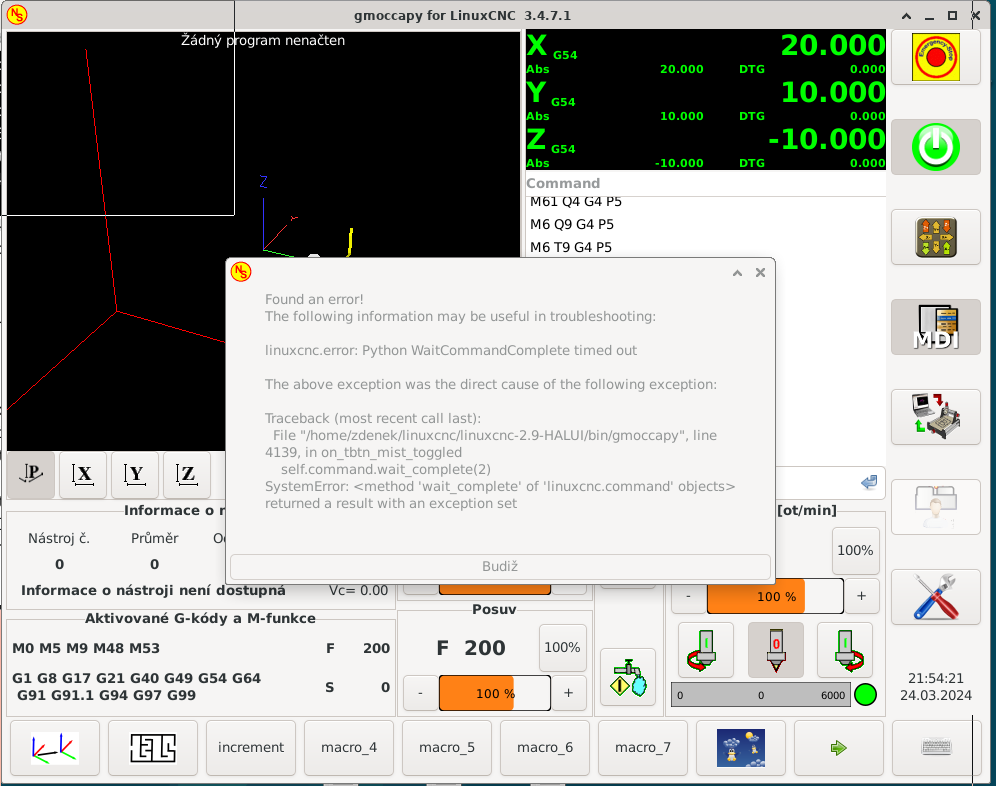

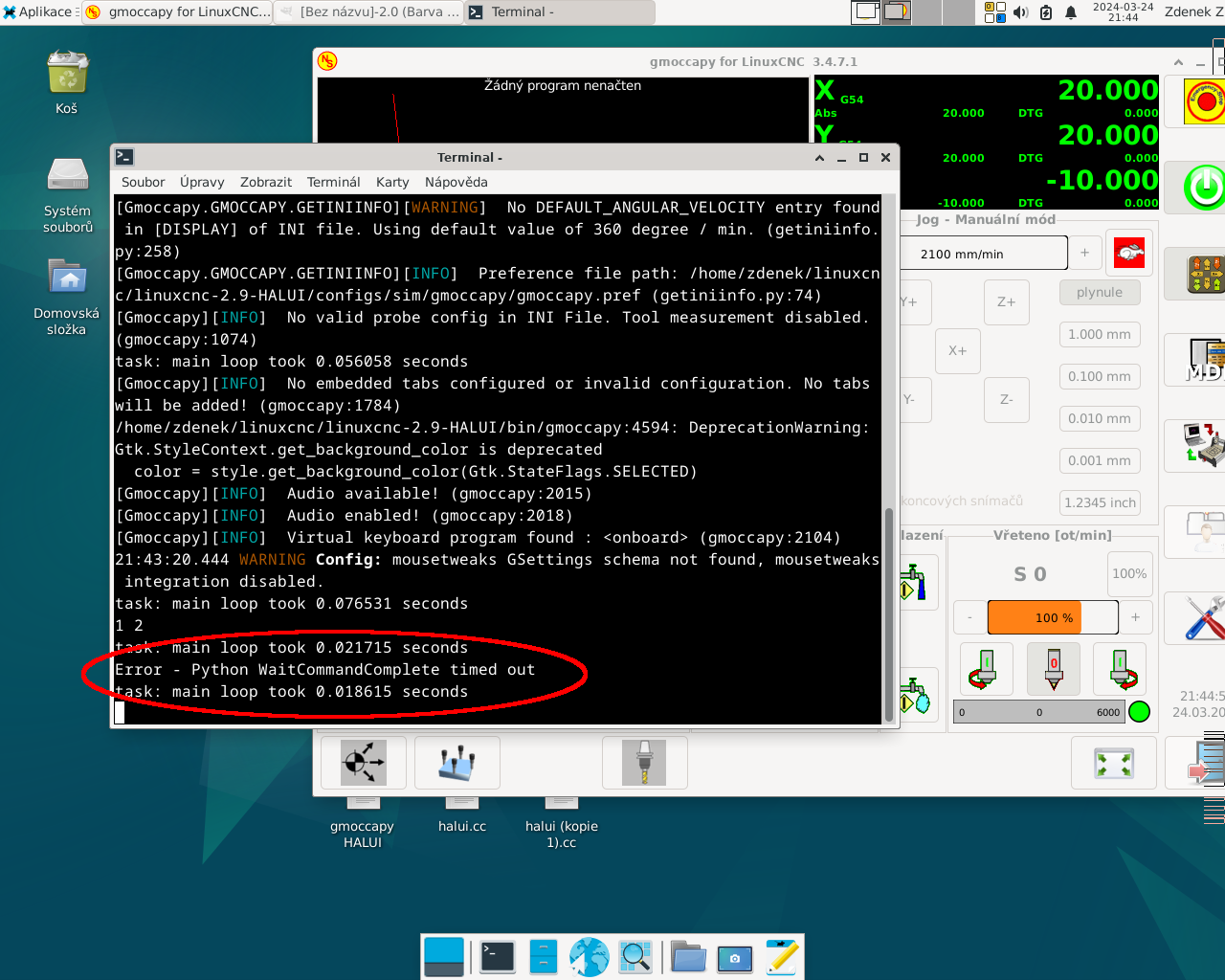

Hello,
Few people know that the command self.command.wait_complete() has a time limit that can be set and the default value is 5seconds.
The problem is that if this limit is exceeded, the source code continues and there is no warning.
I was able to create two kinds of warnings.
1) silent warning with fprintf. If the time limit is exceeded, the source code continues, but at least an error note appears in the terminal.
2) drastically stop the code with PyErr_Format
I would like to make a Pull Request, but I don't know which option to choose. Can any of you think of another option?
github.com/LinuxCNC/linuxcnc/blob/master...ns/emcmodule.cc#L213
self.command.mode(linuxcnc.MODE_MDI)
self.command.mdi("G91 G1 X10 F200")
self.command.wait_complete(2)
self.command.mdi("G91 G1 Y10 F200")
self.command.mode(linuxcnc.MODE_MANUAL)
self.command.wait_complete()The problem is that if this limit is exceeded, the source code continues and there is no warning.

return -1; [attachment=60361]fprintf.png[/attachment]Attachments:

Why don't you check for the error in the python code?
result = self.command.wait_complete(timeout)
if result == -1:
print( 'Command timed out: ({} second)'.format(timeout))

When you know that a time out problem will occur, you can solve it like this. However, a situation happened to me when the program was behaving randomly. It was only after much searching that I found out that WaitCommandComplete has a timeout. I'll be on the lookout for it forever. I would like other developers to be aware of this while debugging their programs. I think it can be very dangerous for moving (eg self.command.mdi("G91 G1 Y10 F200") ). Movements up to 5s are fine. For movements above 5s, the developer will notice that something is weird. Moves lasting 5s will behave randomly.Why don't you check for the error in the python code?
result = self.command.wait_complete(timeout) if result == -1: print( 'Command timed out: ({} second)'.format(timeout))
