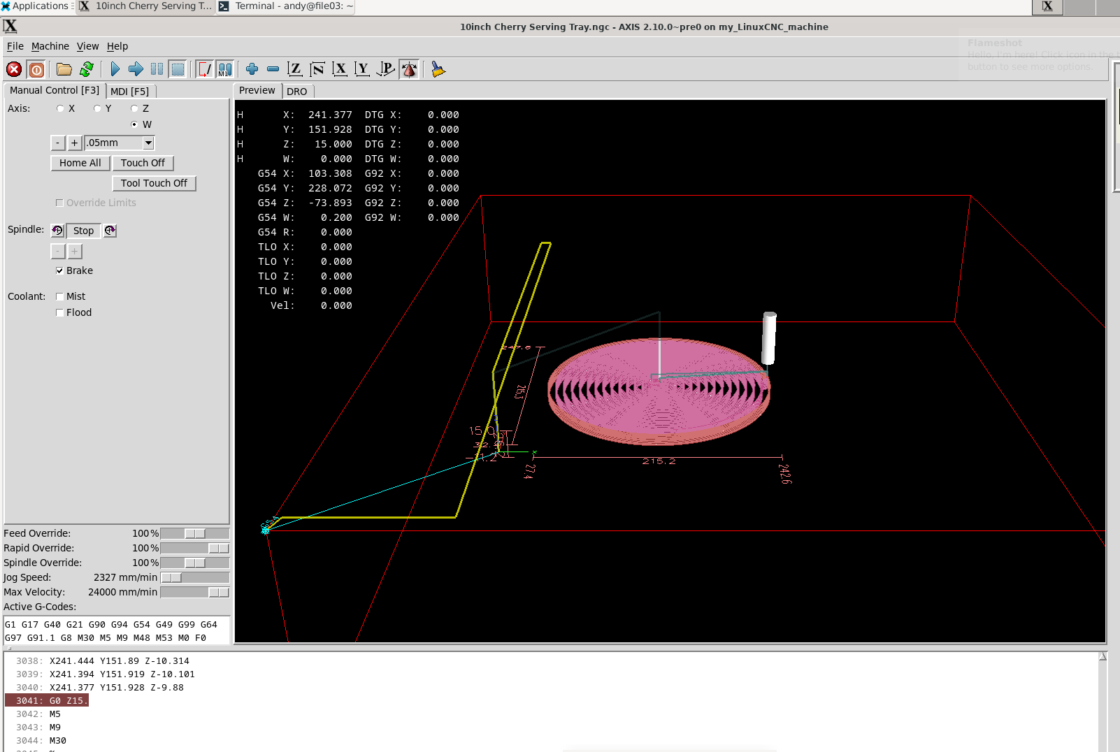

27 Mar 2024 19:24 #296958
by gardenweazel
First Cut return to G54 Origin was created by gardenweazel

Replied by Mecanix on topic First Cut return to G54 Origin
WCS: (Block 1: G54 G28 G0 Z0, Block 2: X0Y0)
MCS: (Block 1: G53 G0 Z0, Block 2: X0Y0)
Not sure what you're asking...

27 Mar 2024 20:02 #296963
by gardenweazel
Replied by gardenweazel on topic First Cut return to G54 Origin
I think that you just answered my question.
If I turn my machine off(I am saving coords to file) am I correct that after homing I can still get back to my G54 coords without a touch off?
If you're making reference to the POSITION_FILE feature, then yeah that's the principle. Given nothing moved between a cold restart you should be able to regain WCS (close anyway, less the backlash and thermal deviation from where you left off, guessing).
Heard the boyz on F360 run probe start-up macros for their parts' WCS. On-machine probing for validation and all that fun automation you should look into this.
