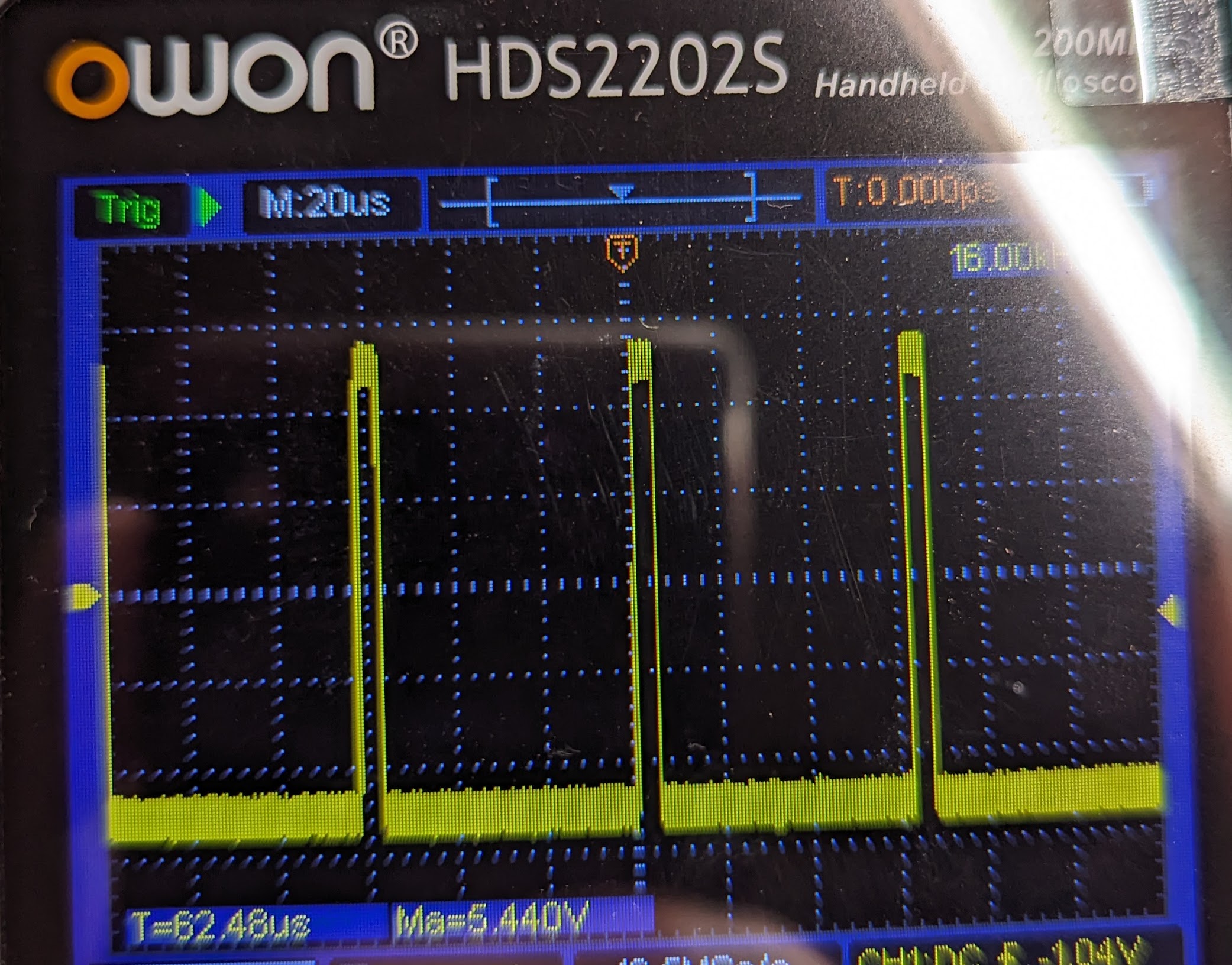

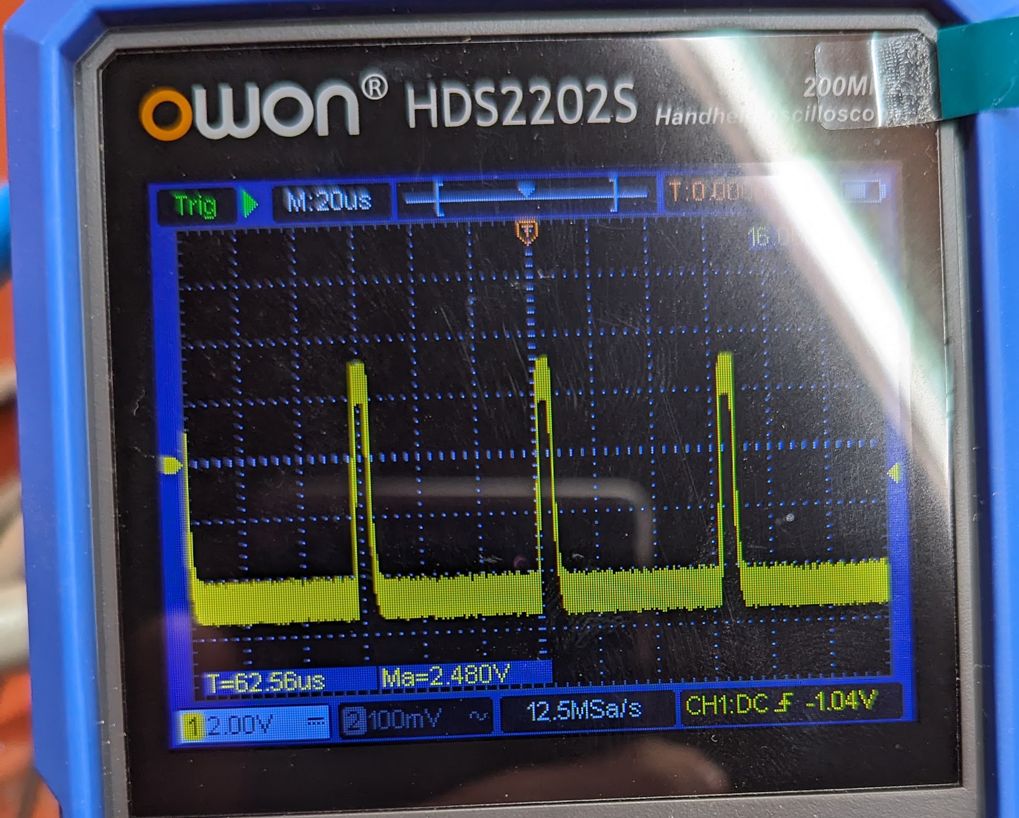

I just checked both channels with an oscilloscope:
When disconnected, channel 1 looks like this:
When connected, the pulses are way lower:
As a control, I also measured on channel 2 (when connected):
I also measured directly on the MESA connector in disconnected state, but both look the same in that case.
So I guess this means that there is a problem with the driver of the JMC...
- Once with the servos disconnected.
- Once with the servos connected, such that one doesn't work.

- knipknap
- Posts: 96
- Thank you received: 6
28 Mar 2024 14:15 #297024
by knipknap
Replied by knipknap on topic Debugging joint amplifier fault
Lower yes, but why the large difference between both servos?
The above measurements are between step+ and step-.

- knipknap
- Posts: 96
28 Mar 2024 14:52 #297030
by knipknap
Good question. The bad motor on the good channel is also pulled down a lot, but only to 3.7V instead of 2.4V.
The specs of the servo say they tolerate a signal voltage between 5V and 24V, so both is well below that.
I am really not sure who is at fault here; the MESA because it cannot provide enough power, or the driver because it pulls too much power.
