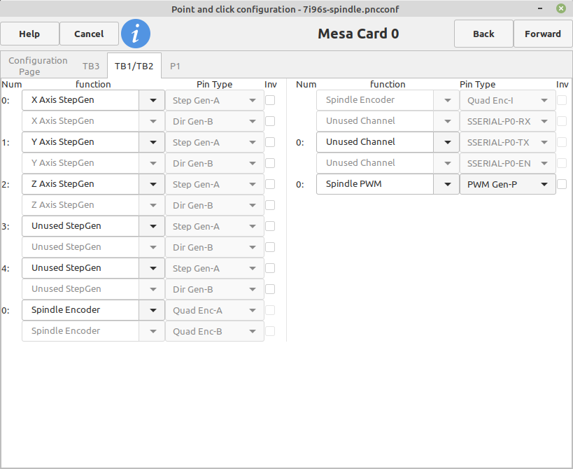

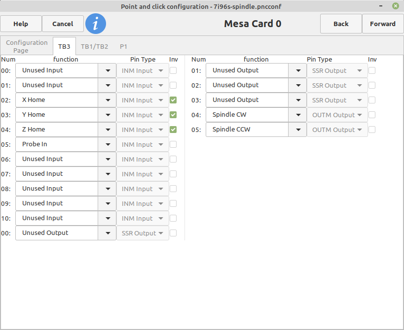

Good morning, I have a Mesa 7i96s board and a VFD with the following pinout. I would like to know what the best option is for connecting one to the other.

VFD 7I96S
10V TB2.24 SPINDLE+
AI1 TB2.23 SPINDLE OUT
ACOM TB2.22 SPINDLE-
DCOM TB3.24 OUT5B
REVERSE TB2.23 OUT5A
DCOM TB3.22 OUT4A
FORWARD TB3.21 OUT4A
10V TB2.24 SPINDLE+
DCOM TB3.24 OUT5B
DCOM TB3.22 OUT4A

"Thank you very much for the prompt response. I've already connected everything, but I can't get the spindle to run on LinuxCNC. Can you help me with the HAL code?"

I need to work analogic 0-10V.
I tried to config it, i can fwd and rev the spindle, but i cant control the speed.
What am i doing wrong?
Maybe some lines missing to convert the pwm to analog?
my hal file is attached

The hal file looks OK, but the ini file is needed also for a full check
Do you have 10V when measured from 7I96S pin 22 to 24?

14 Apr 2024 12:26 #298237
Replied by PCW on topic Wiring VFD to MESA 7i96s
The existing hal and ini files look correct (nothing else is needed)
The spindle is set for 2000 RPM full scale
If you enable the spindle and set the spindle speed to 1000 RPM
you should get ~+5V on P2 pin 23 (relative to P2 pin 22)
(you can do this in MDI mode with "M3 S1000")
