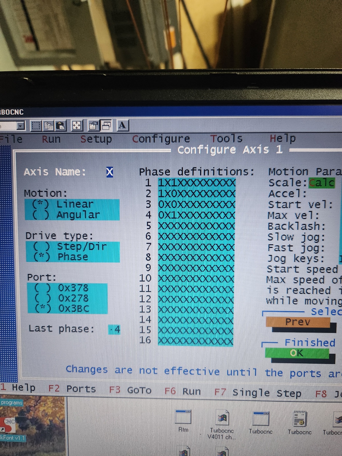

Hello,
I am converting a system that ran on TURBOCNC with MotionGroup hardware. One of the quirks of this setup is its phase drive.
Basically the way I' reading the existing TURBOCNC parameters the 2 pins going to any motor needs to fire in this order 1,1-1,0-0,0-0,1 Using stepgen parameter 5 has gotten me the smoothest(nearly acceptable) results. In forward the motor runs rather notchy but in reverse its very smooth.
But as you can see in the attached HAL I am only using phases A and B. If I could tie a certain phase to both pins so that both fired I think this would do what I need.
Can anyone give some pointers on what to try next?

The pattern you listed is quadrature so setting the
step type to 2 (quadrature) and these connections
should be correct:
net xpina parport.0.pin-02-out <= stepgen.0.phase-A
net xpinb parport.0.pin-04-out <= stepgen.0.phase-B

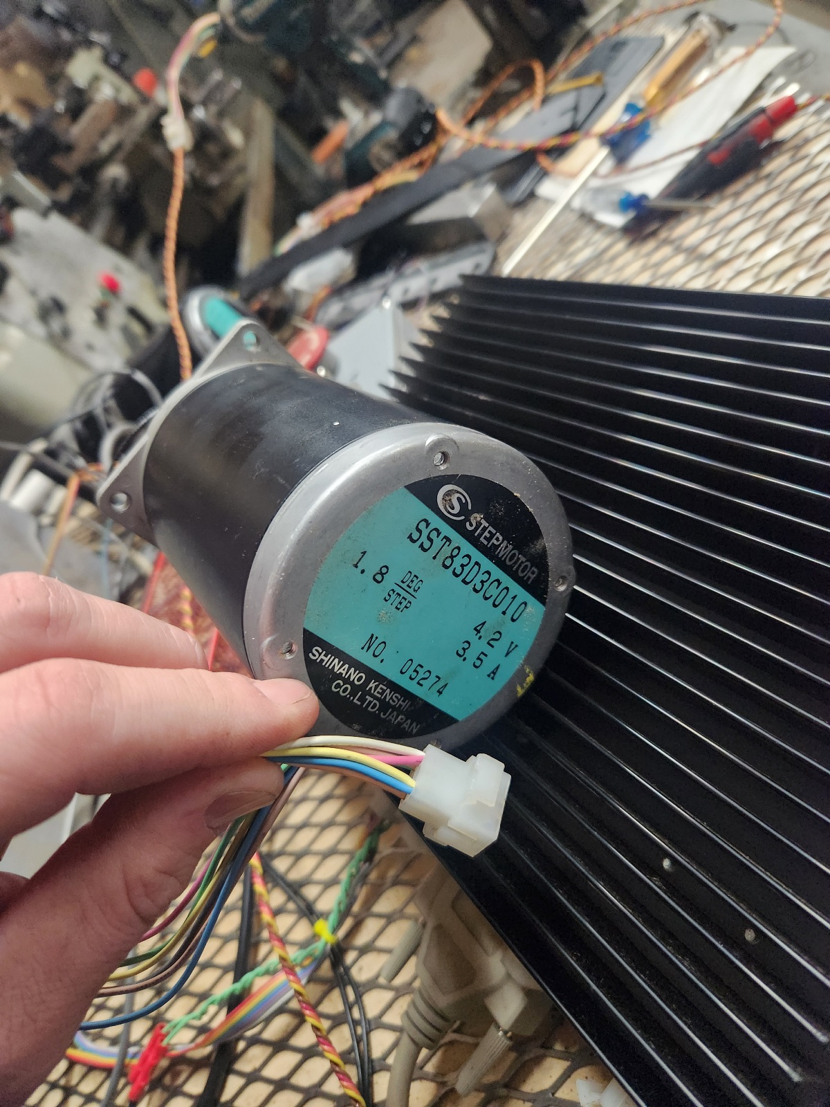

That looks more like motor miss wiring, is that a unipolar or bipolar motor and how many motor wires connect to driver/control box?

I believe the motors are 8 wire(to 4 pins)
rlkey=juwhpldi4pf5wihsfmique97f&dl=
unipolar. www.pikpower.com/documents/SST83DSERIES.pdf

Please upload pictures here on the forum, your first dropbox link insist i register to view, the second gave me two warnings about cross site scripting attacks on my PC. I really do not like drops#it rummaging through my PC.
LinuxCNC can do stepgen types 5, 6, 7, 8, 9, and 10, all for 2 phase stepper motors, what you describe seems like type 8, not 5, so just edit the stepgen type, save and test.
From past experience, the most speed with good torque i got from 6 and 7, most torque from 10 but some stepper/drive combos really do not like it.
But, first, make sure the wiring is correct, no amount of software will help with a unipolar motor wired to a bipolar drive or vice versa.

If you only have 2 output pins, and the drive is not step/dir
or CW/CCW, mode 2 is the only mode that makes sense...
