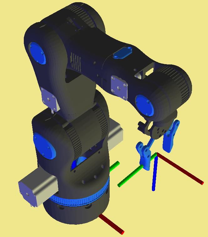

I have a 5-DOF robot based on the LinuxCNC Melfa example. This will be driven with stepper motors open loop.
The gripper is driven by a RC style 180 degree servo motor. How do you control the servo gripper from Linux CNC?
My CNC router uses a Mesa Ethernet card. Is there a cheaper alternative for a hobby robot that works with LinuxCNC?

Remora and RIO can handle RC-Servos with cheaper hardware.
