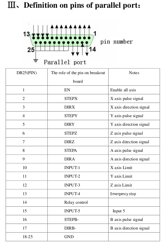

Hoping for some help.
I was using a Dell Optiplex 780 SFF with a 5i25 a G540 and a SuperPID. All worked well until the G540 died. I replaced it with some sainsmart bobs and stepperonline motors/drivers. All worked great until the Dell died. I went with a RPi4 and 7c81 with mx3660x2d firmware. I had to remove the relay in order to use the DB25-14 pin as pwm. The output on that pin ranges from 0.90v to 5v when I click the + for the spindle speed in axis. When I do a M3 S8000 the rpm is something like 15000 and the pin voltage is something like 1.7v. I have the pwm_frequncy set to 50 as I believe is needed. Whats the best way to calibrate the spindle?
Thanks for any help.
I can try to upload my configs if needed.

Replied by PCW on topic Spindle speed via SuperPID
The 5ABOB firmware should match the Sainsmart BOB
(the common one has PWM on pin 1)
Are you using the analog 0 to 10V output?

Thanks for the reply and sorry for the late response.
The reason I'm using the mx3660x2d firmware is according the docs for the bobs I have pin one is enable, see pic.
I'm using 0 - 5v out. I've been doing a lot of messing around with it and can't seem to get the M3 Sxxx to match what the SuperPID displays.
I've switched to qtdragon from axis due to a glade error when adding a spindle tab. The spindle speed in qtdragon matches the SuperPID display.
I believe this is my last ini and hal before giving up.

Any change I made was through pncconf to keep me from making a change while screwing around that I would later forget about and be scratching my head if something was working...
Thanks.
Thanks.
OK that not the standard 5ABOB with the analog output
(I was assuming you were using the analog output)
If you set the spindle speed to 0, I would expect the PWM
pin to read very close to 0 V on a DVM.
Does the SuperPID provide duty cycle vs RPM information?
