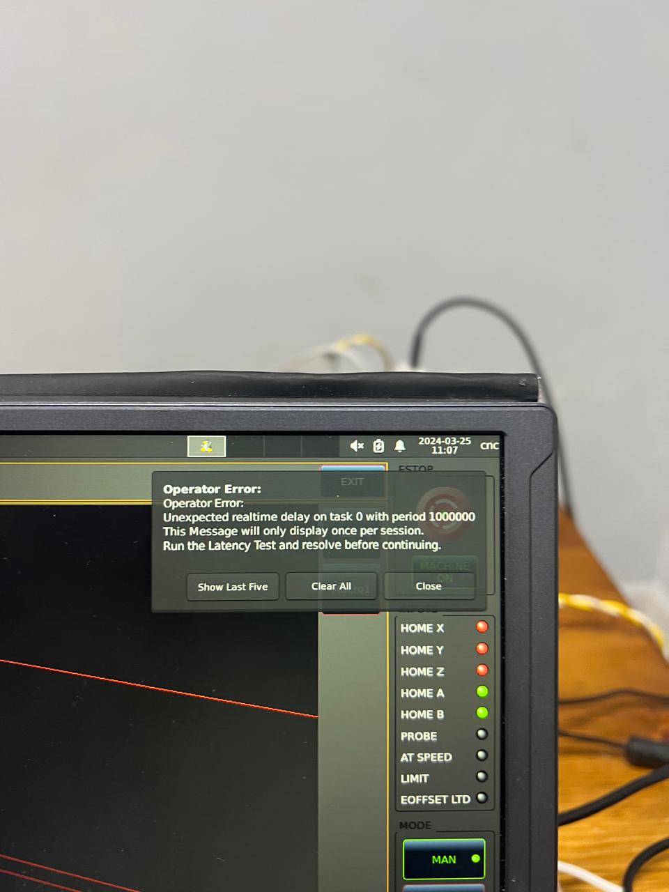

Operaor Error With raspberrypi
- Abdulkareem
- Posts: 77
17 Apr 2024 10:22 #298456
by Abdulkareem
Operaor Error With raspberrypi was created by Abdulkareem
- Posts: 18122
- Thank you received: 5337
17 Apr 2024 10:58 #298457
Replied by PCW on topic Operaor Error With raspberrypi
That indicates a real time issue on the RPI
Have you run a latency test?

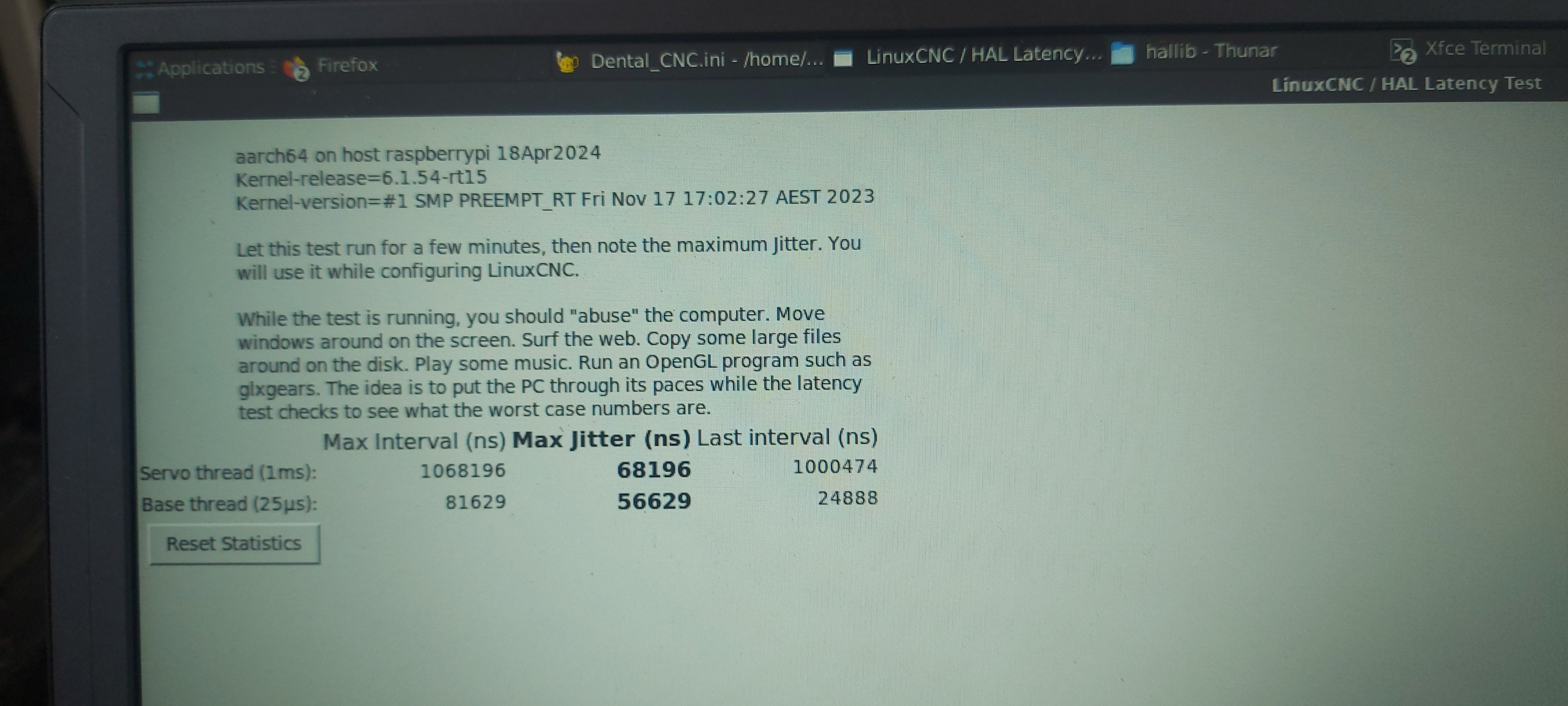

- Abdulkareem
- Posts: 77
18 Apr 2024 06:00 #298545
by Abdulkareem
Replied by Abdulkareem on topic Operaor Error With raspberrypi

It's going to help if you can describe your system, are you using ethernet, SPI or gpios (software steeping). Mesa, remora or other hardware.
Your HAl & INI files will help as well.

i am using ethernet and mesa 7i96s

Typically with a RPI4 you need to
set the force_turbo option true (in config.txt)
set isolcpus to 2,3 (in cmdline.txt)
You may also need to lower the servo thread
period to 2ms (2000000)
The following user(s) said Thank You: Abdulkareem

How to lower the servo thread period?
- Posts: 18122
21 Apr 2024 10:09 #298784
Change
SERVO_PERIOD = 1000000
to
SERVO_PERIOD = 2000000
to
The following user(s) said Thank You: Cant do this anymore bye all, Abdulkareem
