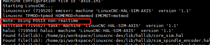

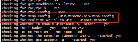

Thank you all for the suggestions. Unfortunately, using Xenomai 4's EVL with LinuxCNC didn't work for me; I've tried everything.
Following my instructor's advice, I switched to using Xenomai 3 for the build. (this is a topic I'm exploring)During the build process, Xenomai was successfully detected.
However, when running it, the real-time core of Xenomai still wasn't utilized.
I found some posts on the forum from a few years ago with the same issue,
but I couldn't find a solution. Do any of you have new suggestions?forum.linuxcnc.org/9-installing-linuxcnc...ith-xenomai3?start=0

I would like to understand this myself.
Is there any evidence of the uspace_xenomai.cc file being compiled?
Maybe you could try installing the uspace 2.8.4 deb + matching uspace-xenomai deb on your Xenomai3 system and see what happens?
This is where the rtapi wrapper app prints "POSIX non-realtime" or "POSIX realtime" and it is still looking for Xenomai: github.com/LinuxCNC/linuxcnc/blob/master...ce_rtapi_app.cc#L797
- engineer
- Posts: 2
27 May 2024 20:03 #301611
by engineer
Replied by engineer on topic run Linuxcnc on xenomai with EVL(the realtime core)
I refer here to main branch of linuxcnc 2.10 (master or devel) and it works with Xenomai 3.
You done everything correct but apart building LinuxCNC to Xenomai the LinuxCNC at runtime checks if it has Xenomai kernel.
In order to fix the issue you must edit file: "linuxcnc/src/rtapi/uspace_common.h", around 386 line of code you find:
#ifdef USPACE_XENOMAI

As you see to check what kernel you got it uses very well known "uname" function. The problem is that at the moment Kernel build with Xenomai (new versions) and checked with "uname" does not include word "-xenomai" anymore but from what I know it has "IRQPIPE". That is what I got. Change what requires to be changed, recompile linuxcnc run again and... happy days.
It took me a while to figure that one out when I was compiling mine so I save you headache.
Probably that change should be commited to git
