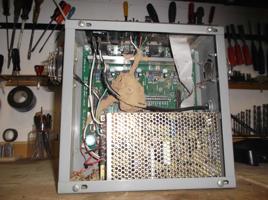

i may have a greater problem, discovered this morning !
This is the box housing the controller, ex a 'Supercam' setup, which was my starting point years ago.

Replied by tommylight on topic Limit switches
I have seen much worse, but never such concise structure !
From that picture, from the parts placement and diodes at the outputs, those seem to be L287/L298 stepper drives.

Many thanks for your precise reply.
The 'nest' has now been removed, but I need to do a final clean up !
John
John
