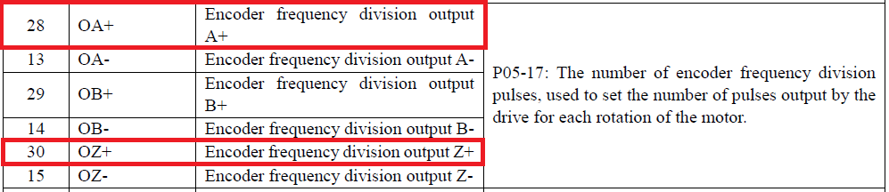

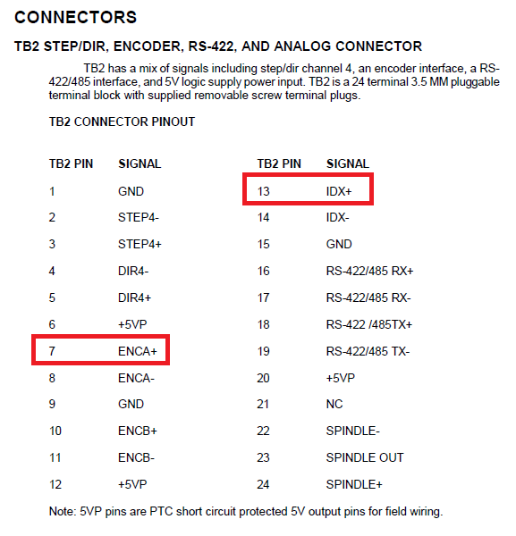

Thank you PCW, I also see your post edit that I can actually just connect my 1PPR signal to the Mesa, though to both A and I connector.
PS: I suppose i would use ENCA+ and IDX+ on the Mesa card, and OA+ and OZ+ on the servo drive.
If you wouldn't mind PCW, just for the sake of learning something new today; why do you suggest doing this? Will there be an advantage over just connecting them all up? I mean, I have all 6 outputs readily available on the driver, and all 6 corresponding connections on the mesa card.
or what about using it as a single ended encoder, with just A+, B+ and Z+ connected, which to a newbie liek me seems like a more "complete" setup, but still saving a little on connections.

I would use all 6 connections (fully differential)
just because its simpler to setup, has better noise
immunity than single ended, uses the standard hal setup,
and does not require LinuxCNC 2.10
I was mainly pointing out that 1 PPR threading should work well
with servo spindles since they should run at a very constant speed
(unlike say a VFD with varying load and LinuxCNC just guessing the
speed between index pulses)
