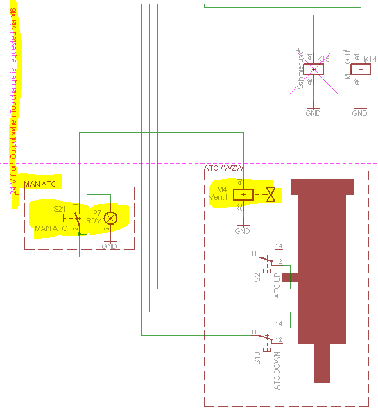

I want to have a button close to my spindel with a light to change the tool by hand (no automatic changer available for now). Thinking about how to activate this button (the light should indicate, that the button can be pushed to change manually - so spindle is at thero speed and disabled and..)
Now I found this hal component. Could this be a way of how I can "supply" / "activate" my button / light?
That means I will have to do a tool change by entering the m6 command in the mdi line each time right? But the bennefit of the hal file will be that linuxnc is checking if motion is stopped and will wait to accept a spindle run until I press continue / tool change is ready. So I could make sure my hands are safe during change.
Is this a good idea to use it in my case or bad?
Please notice the sketch of attached of the button, light and tool clamping valve.

You can add a VCP panel with that button, link it in hal to the physical button and also make it do whatever you want, so issuing an M6 is easy, having it also check if the spindle is at 0 speed or disabled is a bit more work, about 3 to 5 lines in hal, probably.

VCP means Virtual control panel? So adding a software button?
I just want to go by a physical hardware button. Direct connected to the valve for unclamping the tool like in the schematic.
Could you explain a bit more in detail?
My though was to i could maybe go with the hal_manualtoolchange.
If hal_manualtoolchange.change bit in (Receives signal to do tool change) is active I will foward this to an output of the mesa card to supply my button.

you need an input for the button and and2 it to the tool change pin.
The output from the and2 would be connected to an output pin that triggers your relay or whatever.

Now I have wired the button to an Input Pin and the ATC-Valve to an Output.
So I did the configuration now like this in .hal (atc_button is and2 instance):
when I now type "M6 T5" as MDI I can push my button and the ATC valve is acting.
BUT after changing the tool by hand Linuxcnc (gmocapy) still says T1 is inserted.
How is the procedure here to commit the change?
Are the nets "tool-change-confirmed" and "tool-number " needed somewhere? Or are they just in as a standard for user adjustment / routing?!
By the way: "I have no idea how it´s done usually - cnc newbie"

Yes, I'd say you are lacking some feedback signals.
Try to add these to your hal:
net tool-prep-loop iocontrol.0.tool-prepare iocontrol.0.tool-prepared
net atc_zylinder iocontrol.0.tool-changed

thanks for your help. i have now comment one more line to use the io tool-prepared.
when i now push the button after M6 Tx it justfires a small pulse to the atc_zylinder and then it shows the correct toolnumber in linuxcnc.
BUT the small pulse is to short to insert the tool / unclamp. I think that pushing the button fires the tool changed and then tool-change is not active anymore.
Maybe a way could be to watch the button rising and falling edge??
or could it makes more sense to tr the hal component "manualtoolchange" out?

If you need a pulse on a falling edge have a look at the 'oneshot' component, which has a parameter setting for falling edge detection:
linuxcnc.org/docs/html/man/man9/oneshot.9.html
