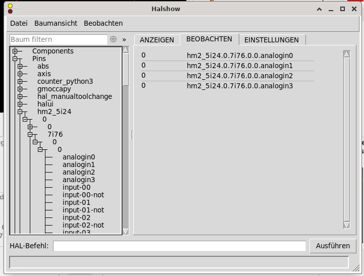

Hello,
I need your help again.
I can´t readout the value of the analog input from the 7i76 (see the picture).
The settings in the INI-File is as follow:
loadrt hm2_pci config=" num_encoders=7 num_pwmgens=0 num_stepgens=5 sserial_port_0=10xxxx"
Please help me to find out the problem.
I use LinuxCNC 2.9.2.
Best regards
Ludwig

Replied by tommylight on topic 7i76 analog input
How are you trying to read them?

Just connect 24V to TB6 pin 4 and read
net analog3 <= hm2_5i24.0.7i76.0.0.analogin3 => spindle_load.bar_spindle_load

Pin 1 on header will be pin 0 in hal.
Does Mesa 7i76 have field power?

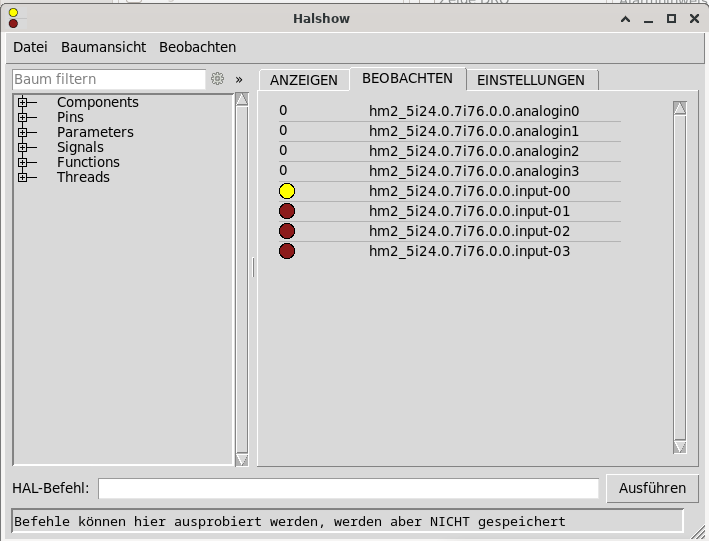

Does digital input 0 (same pin as Analog-0)respond?
If not, that suggests a communication issue

Yes, digital input shows 1, and the fieldpower is also connect.

That is a somewhat weird hardware configuration (50 pin FPGA --> 25 pin daughtercard), what does:
sudo mesaflash --device 5i24 --readhmid
show?
Also what is the 7I76 firmware version
DId you try mode 2?
show?
DId you try mode 2?

I try mode 2, same result. Only there show encoder0 , encoder1 and fieldpower pin.
How to find the 7i76 firmware version?
And the 7i76 is connected to the 5i24 by DB25pin connector.

Here the 7i76 firmware version:
sudo mesaflash --device 5i24 --sserial
SSLBP port 0:
SSLBP Version: 1.43
SSLBP Channels: 2
SSLBP Baud Rate: 2500000
sserial device at channel 0: 7I76 GPIO+SPINDLE (unit 0x1000037C)
SwRevision = 14
HwRevision = 1
NVBaudRate = 2.5Mb
NVUnitNumber = 0x1000037C
NVWatchDogTimeout = 50ms
SOFTWARE MODE IO_Spin [index 00]
SOFTWARE MODE IO_Ana_Spin [index 01]
SOFTWARE MODE IO_Enc_Ana_Spin_FV [index 02]
SSLBP port 0:
SSLBP Version: 1.43
SSLBP Channels: 2
SwRevision = 14
HwRevision = 1
NVBaudRate = 2.5Mb
