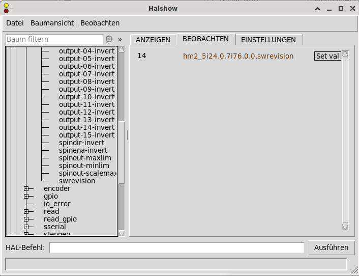

17 May 2024 13:45 #300854
Replied by PCW on topic 7i76 analog input
That would be the parameter hm2_5i24.0.7i76.0.0.swrevision

18 May 2024 10:48 #300918
by Ludwig
Replied by Ludwig on topic 7i76 analog input
any idea ?
Maybe I miss some settings in the INI or HAL files ?
The hardware locks ok. because there show the digital inputs, only the analog inputs show nothing .

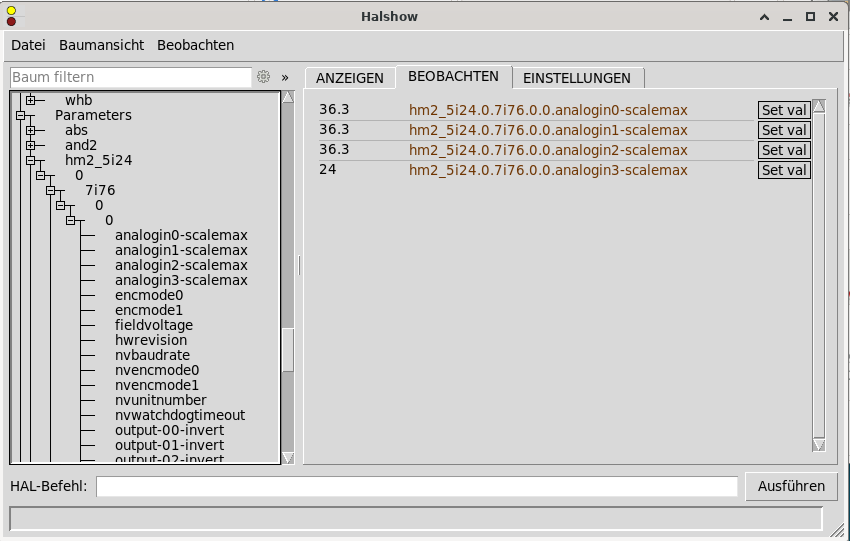

- Posts: 18122
- Thank you received: 5337
20 May 2024 08:19 #301002
I skipped one very important setup question:
What are the scalemax parameters for the 7I76 analog inputs?
- Ludwig
- Posts: 36
20 May 2024 09:18 #301008
