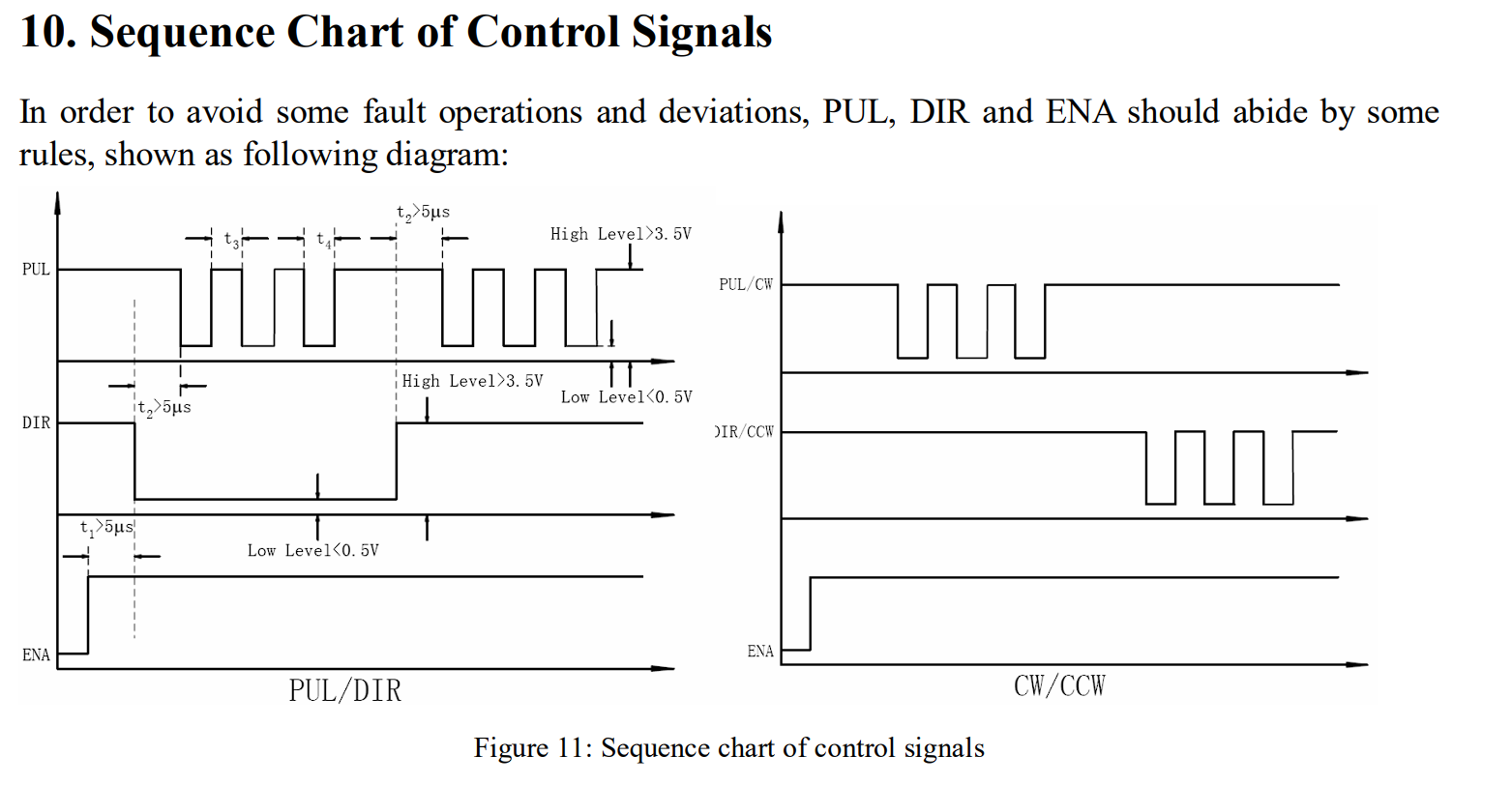

So I have a question to get me edumacated
So, I've seen a pile of questions related to Step on-time and Step space and it seems there's just a general rule of thumb for some numbers to put in as starting points. unfortunately, it drives my mind crazy. I would gander to think that every driver has a specific number for it but from looking at tech documents it is a bit hard to decipher especially when I don't really understand what it relates to (well somewhat understand). so, if I were to look at say documentation for the Gecko 201 because PNCconf has those settings already defined how would I pull that info out from the documentation or are those settings readily available because it's a drive that has been used more prominently?
I ask because I recently emailed the tech / support department at Stepper-Online and they had no idea what step on-time and step space were. found it rather odd that they would not know what info it was I was after. Their documentation doesn't seem to be lacking and appears to be about as detailed as say Gecko documentation.

23 May 2024 11:04 #301225
by FlaredFins
Replied by FlaredFins on topic Step on-time step space

23 May 2024 11:46 #301228
by FlaredFins
So how do you take that info and translate it into Step On-time, step space dir hold and dir setup?
- Posts: 18122
- Thank you received: 5337
23 May 2024 12:19 #301233
Replied by PCW on topic Step on-time step space
Step time = T3
Step space = T4
Dir setup = T2
Dir hold (missing from chart)
One really important thing to understand is that these are all _MINIMUM_
timings so unless you run into speed limitations, there is no reason to use
minimum values. In fact using minimum values increases the chance of problems
Step space = T4
Dir setup = T2
