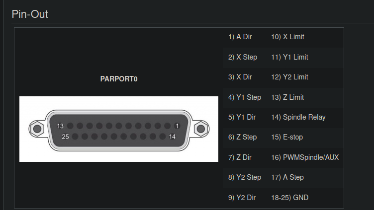

Here is a link to my CNC controller. www.probotix.com/UNITY
- Posts: 4819
- Thank you received: 2177
31 May 2024 10:36 #301961
Replied by Aciera on topic I need help
use the 'StepConf' to setup your config and assign the pins according to this pinout:
www.probotix.com/wiki/index.php/Unity_Controller#Breakout_Board:
More information on the StepConf tool:
linuxcnc.org/docs/html/config/stepconf.html
As for setting up the motors, steppers usually have 200 steps per rev. According to the web page, your motor drives seem to be preset to 4x microstepping so 1 motor revolution would need 800 steps in addition to that you'll need to figure out the pitch of your lead screws to calculate the required number of steps to move the axis 1 machine unit (presumably 1 inch in your case.)

I found a configurator script for Linuxcnc 2.6 here:
www.probotix.com/wiki/index.php/PROBOTIX...inuxCNC_Configurator
Note that this will not work for Linuxcnc 2.8 or above but the script attached below will give an idea of the settings needed for what you have.
For example the MondoStep drivers.
search the file above for 'mondostep' and you will find this:
which tells you that for x and y the scale should be 1600 steps per inch and for the z axis it's 800*TPI of the z leadscrew.
As for that you can then search for 'ztpi' and you will find this section from which you will glean more information about the max velocity:
As for XY limits there is this section:
Could be quite useful.

Hi, I have it moving using the stepconfig test buttons. It will also move clicking on the jog buttons. I have figured out how to load a G file. Biggest problem right now is that it won't run a G code file, at least I don't know how to do it. I need some help with this. Spelling out the basics is what I need right now.

I seem to have most things running. I still need final calibration.
Current problem is although I can jog around using the mouse and software keys I can not run a file nor turn on the spindle.
I think I have things correct but this eludes me, any ideas where I have gone wrong?

Do you get any errors?
Could you post your .hal and .ini files or the compressed machine config folder?
