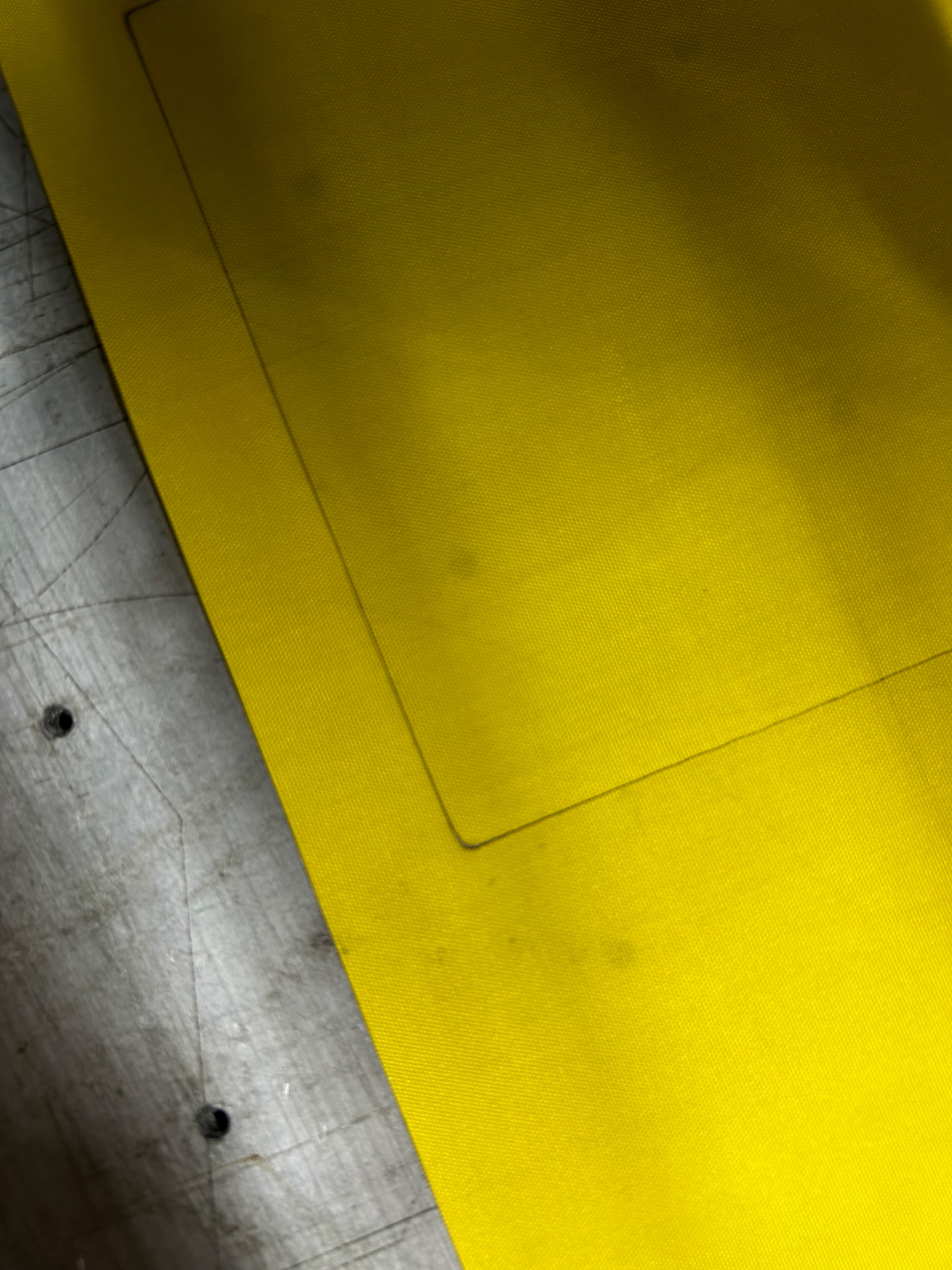

Hello!
im currently running a laser setup with qtplasmac where I impose the % power with a potentiometer and voltage display.
but I would like to impose power with the “Cut Amps” parameter from Qtplasmac. This seems to be the most common approach with qtplasmac.
the problem is that on “pierce” and slowdown, the laser leaves the material burned.
I’ve seen Chinese controllers connected to Lightburn or Rdworks to allow for “min-power” and “max-power”, dependant on the % of max velocity, so if the axis is really slow it will decrease the laser power.
How can this be achieved within linuxcnc? Is there a way to enable this function with qtplasmac while still having the max power to be imposed by “Cut-Amps”? Even if laser power is given somewhere else, is there a way to scale it in lower speeds?
in the picture, the problem is visible, but it is much worse in other materials.
any help will be greatly appreciated.
thanks in advance

You could use motion.current-vel and the scale component to do this in hal
A better option might be to pass the current velocity through the
lincurve component to allow linearization since there is probably
not an exact linear relation between velocity and power needed
for the best cut

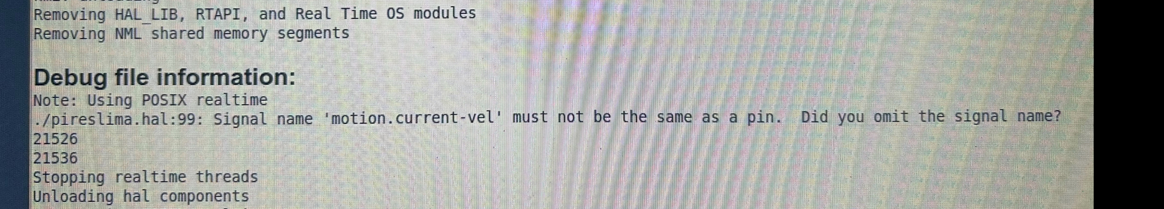

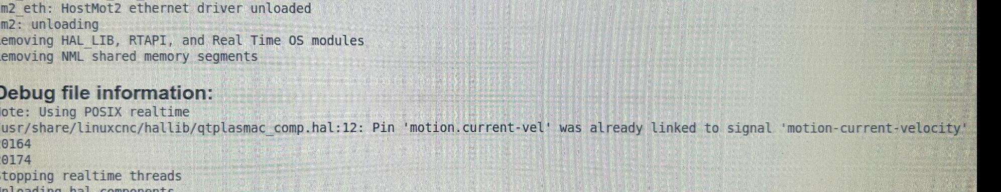

Hey. I've been trying this but no success entering the current velocity parameter into lincurve. i always get the same 2 types of errors, no matter how much i try to "juggle" the variable around. what can i do? ive been trying with motion.current-vel and qtplasmac.current-velocity at first i tried directly, now im trying to pass it through a scale.2 first, but it gives me the same 2 errors.the errors are either that signal name motion.current-vel can’t be the same as a pin, and if I put a pin it says that motion.current-vel is already linked to such pin. Here is the Hal code:

It's a bit hard to tell because you don't have the line(s)
that caused the error in your hal file example.

.hal:99: Signal name 'plasmac.current-velocity' must not be the same as a pin. Did you omit the signal name?
7168
7178
Stopping realtime threads
complete hal file attached
7168
7178

Replied by rodw on topic Scaling power based on % of imposed velocity
you are missing a signal name after net and before the pin name.net my-plasmac-vel plasmac.current-velocity => scale.2.in
