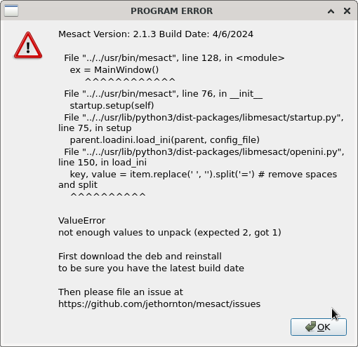

Hello there,
I have a problem with my Mesact 2.1.3 when I click to launch the tool, it gives me multiple errors with a message that says to remove and reinstall a new package. The problem I am currently having unable to delete it from the file manager. Every time I right-click on the.deb file and select remove, it won't do anything. my question is how can I delete it from the terminal so I can install the new version 2.1.4.
thank you

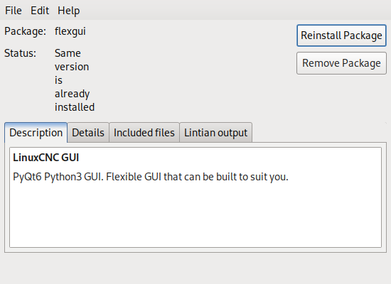

Looks like you're trying to open an ini file, can you attach that file? I don't get any errors here opening an ini file created with Mesa CT.
You can't delete an installed deb with the file manager, as cornholio said you have to right click on the deb and open with gdebi and select Remove Package.
JT

I have figured out what is causing the error you have an entry in the ini file with no value ie:Hello there,
thank you
DISPLAY = axis < good
TESt < errorJT

In Mesa CT 2.1.4 having a malformed ini file with no value is no longer an error it is ignored.
JT

Thanks for the support,
Apparently, I had an error in my ini file, which is all fixed now and downloaded 2.1.4 version
thank you
