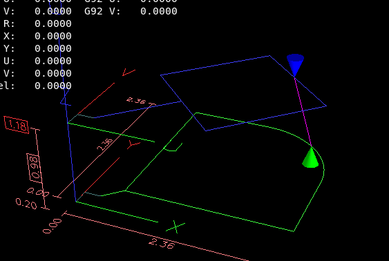

One thing that is still 100% unclear for me is foam cutter visualization. There is some magic code in Gremlin for this. I never worked with such kind of machines. Is there any LinuxCNC documentation regarding foam cutter setup? Or may be one can explain in short?

Have a look at the foam simulation config 'configs/sim/axis/foam/axis_foam.ini'.
Basically it produces two separate previews, one for XY and one for UV
[edit]
Note that the Z,W height comes from the gcode lines (there are no actual Z or W axes)
(AXIS,XY_Z_POS,5)
(AXIS,UV_Z_POS,30)
[edit2]
The idea is that the two cones represent the end of a hot wire cutting through styrofoam

Thank you, that is clear now!
