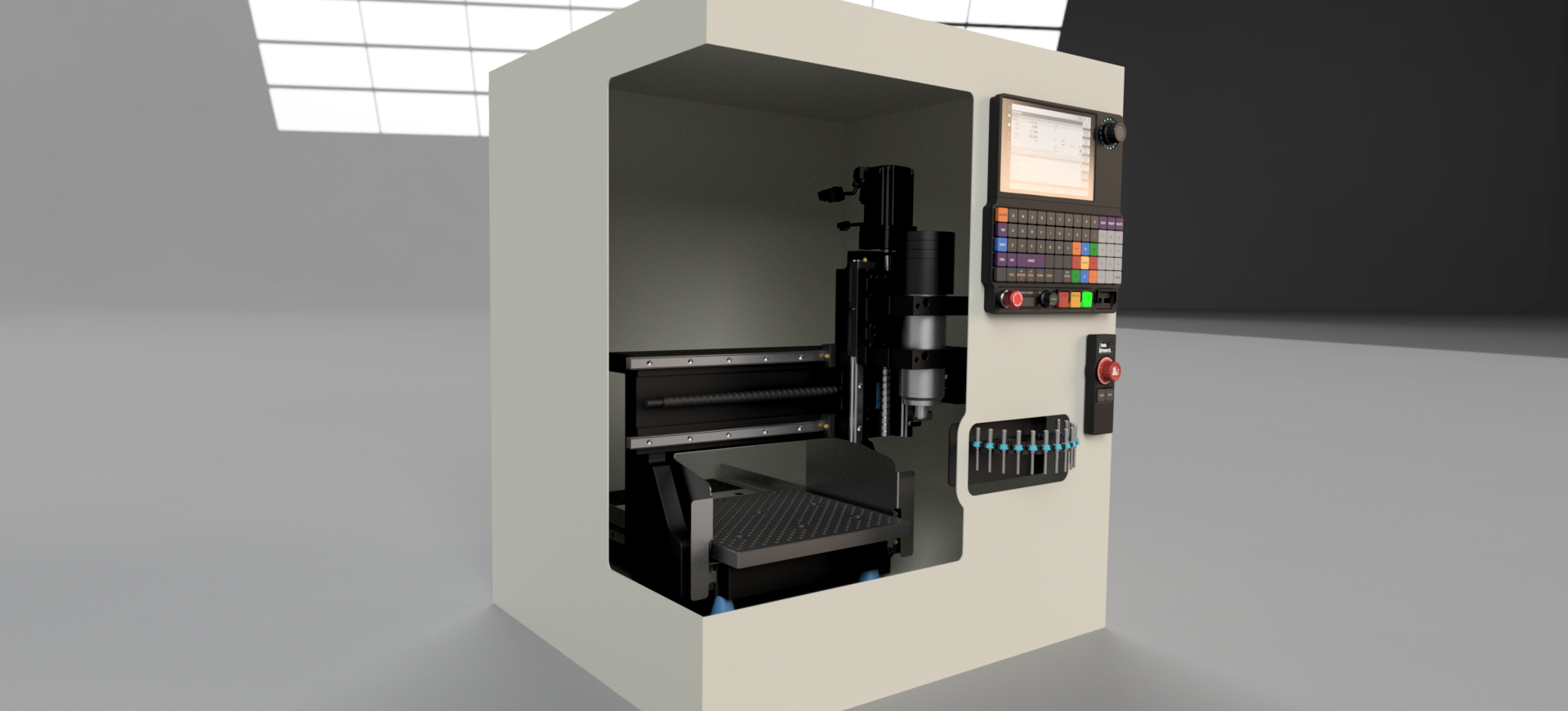

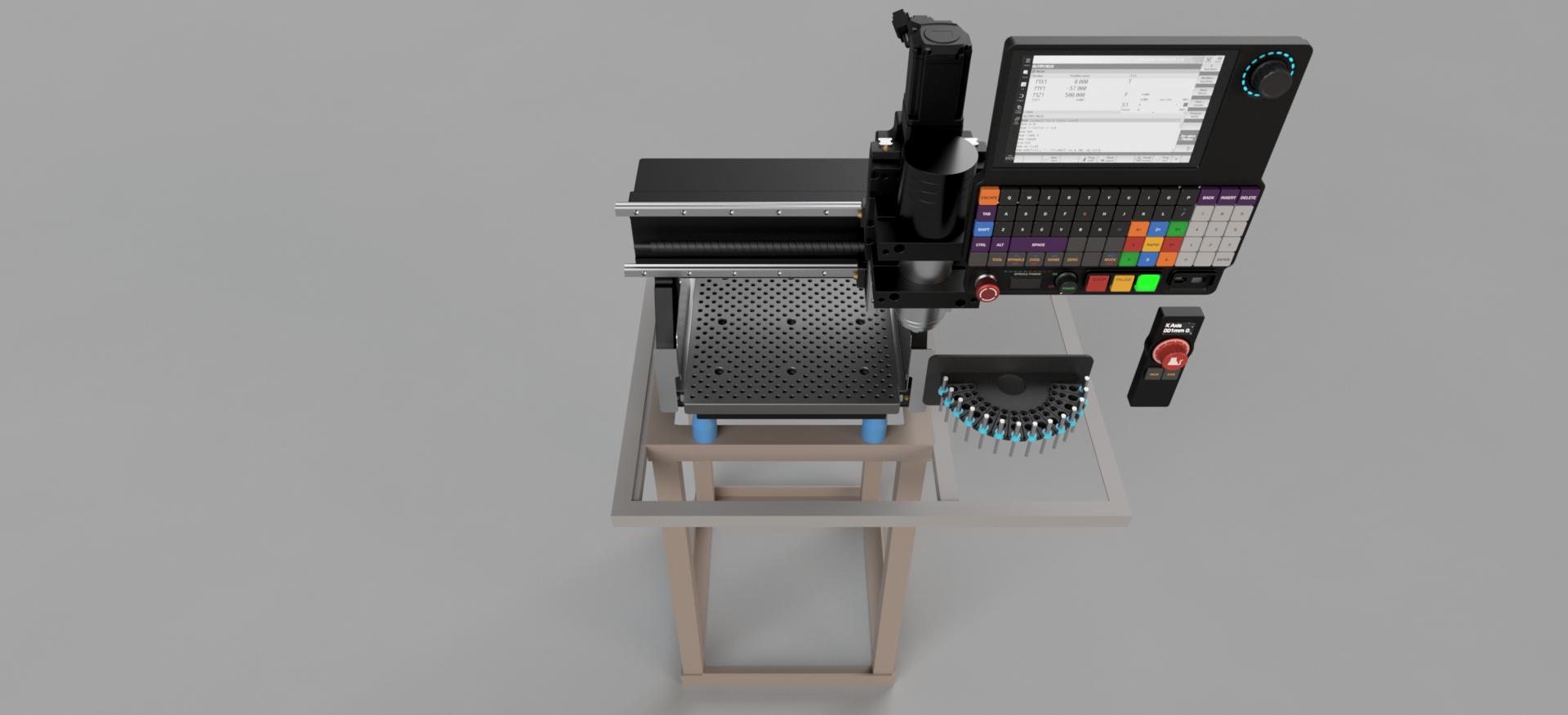

So, The hardware portion of my minimonster (datron wannabe) mill is ready, and I now need to lay out the control "for real".
First up, I need to decide on the system. I want to stay with linuxcnc at this point for cost and flexibility, and with renewed work on jerk control it seems like a good plan. Anything "better" would add several thousand to the machine and lock me into their system.
So, lets see what we need
1: axis drives. Planning on using Delta B3 drives. There are pulse versions, and then there are ethercat versions. Is ethercat in linuxcnc at a stage where it "just works" yet? Can it read an absolute encoder to remove the need for homing? Related: what lower cost options are there for ethercat IO?
2: spindle drive. Is there a way to track rpm/bogging down at the control lever on a spindle with no encoder? Maybe something optical? Do we gain anything by not using tradition analogue control? I think the drive has modbus/rs485 (delta ms300).
3: ATC magazine. My atc will be spin by a small 24v ac servo. I expect I would run it as an axis, but I need some safety and inteligence. Anyone ever implement a system that not only check the mag position, but also actively knows if a tool is in it? Is this something best done in an MCU than then sends out more simple responses to linuxcnc?
4: Active chatter control. Anyone got any thoughts one this? The principle is you bond an accelerometer to the spindle nose, and if chatter builds up, you can respond in several ways. 1 is to pause the program. Another is to modulate feeds or spindle speeds. Superficially seems an easy feature to add but I have never seen it done yet.
5: 3d tool measuring. I am looking at a little laser tool setter and it can in theory measure both the length and the diam of the cutter. Do the available probing cycles in linuxcnc/probe basic allow for such a thing?
6: Limit swapping. My ATC and tool setter live outside the cutting volume. We had the same issue on the brothers. Did someone figure out a simple easy way to "switch envelopes"? Move soft limits, ignore limit switches etc?
That's kinda the core of what I'd like that I am unsure of right now. Any thoughts on any of these are welcome. The rest is relatively straight forward.

I can't answer all your questions but:
1. Ethercat has always just worked. It just how much work there is between just and works has reduced
. If your drives are CIA402 compatible, its easy as there is now a generic driver here at the official driver repo github.com/linuxcnc-ethercat/linuxcnc-ethercat/tree/master
1.a Some people have used absolute encoders. Homing might be a work in progress. I am waiting for a bit of hardware to test my repo github.com/rodw-au/cia402_homecomp home_offsets and gantries are not supported at this stage.
2. My modbus spindle shows accurate RPM and also load. Finding an affordable encoder input is problematic outside of beckhoff.
This one www.icp-australia.com.au/product/ecat-2074a/
And this Chinese one is interesting and would cover your IO too.But you would need to build a generic driver for it. www.icp-australia.com.au/product/ecat-2074a/
For cheap I/O, Rtelligent has one I use that includes some PWM outputs (16 in, 16 out). There is also one by Deiwu. I have built generic drivers for both. XML are in here github.com/rodw-au/linuxcnc-cia402
Limits and home switches (if needed) can be attached to the drives and then you home internally so IO will be limited don't discount Beckhoff.

4. That one would be easy enough, either mcu that reads values and hits a pause button, a python script that does the same. Sure you could make a half component do that as well.
3. Figure a simple induction or ultrasonic sensor could read if the tool is occupied. Don't think this one would be easier with an mcu.
5. Should work fine. Don't think probing cares what the tool setter is. But don't have much experience here
2. Might be able to get rpm with a simple 1 point sensor,. If not find a vfd that has closed loop control such as SV (Sensorless vector) which monitors the rpm with extra circuitry (gs20)
1. If everything is ethercat then go that route. I bet you could figure out a wauly to use the IO of the servo drives. Most have 3-4 of em.
If not then mesa and step dir is hard to beat from a simplicity and reliability side.
6. Not sure on this one
