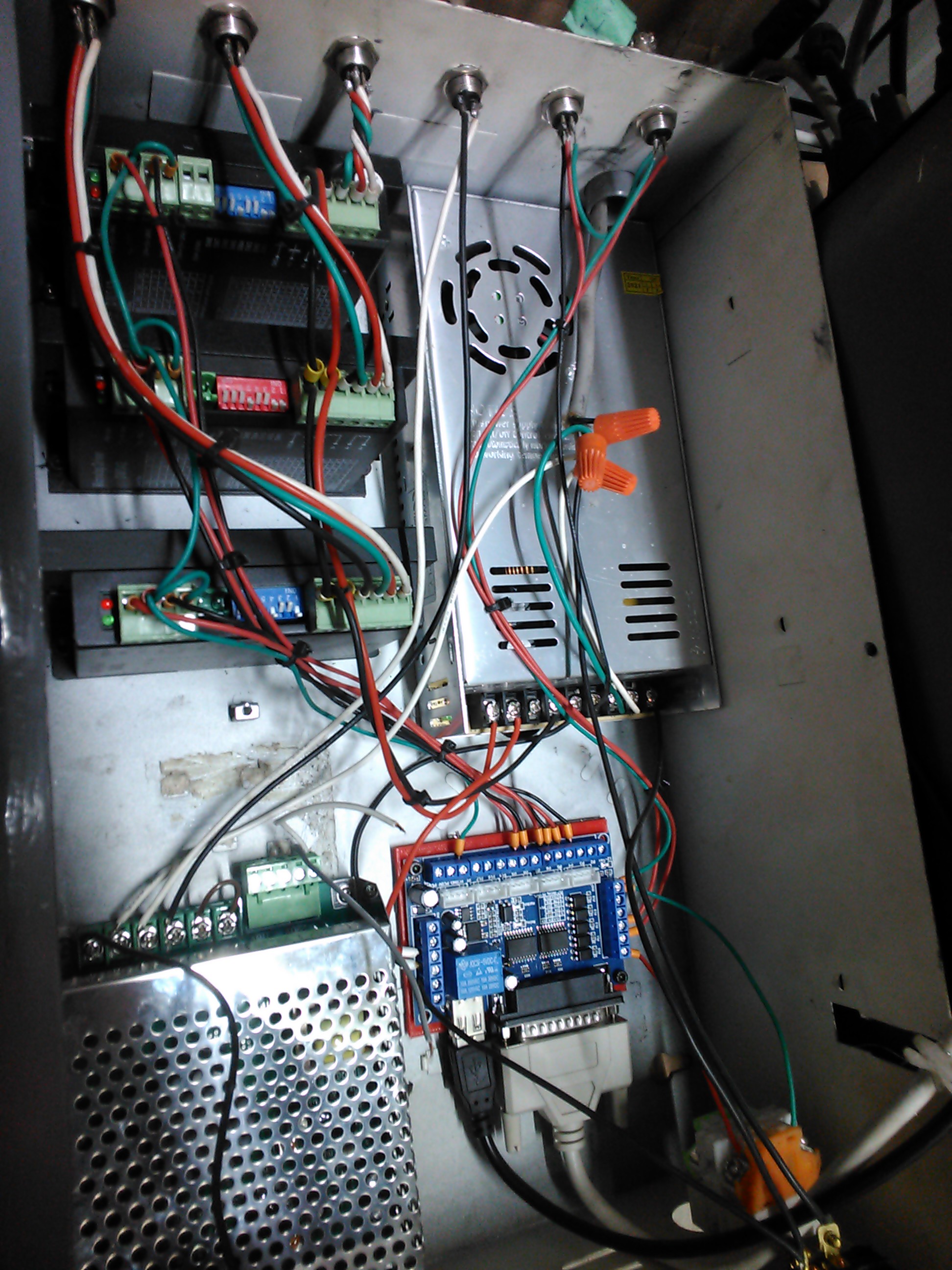

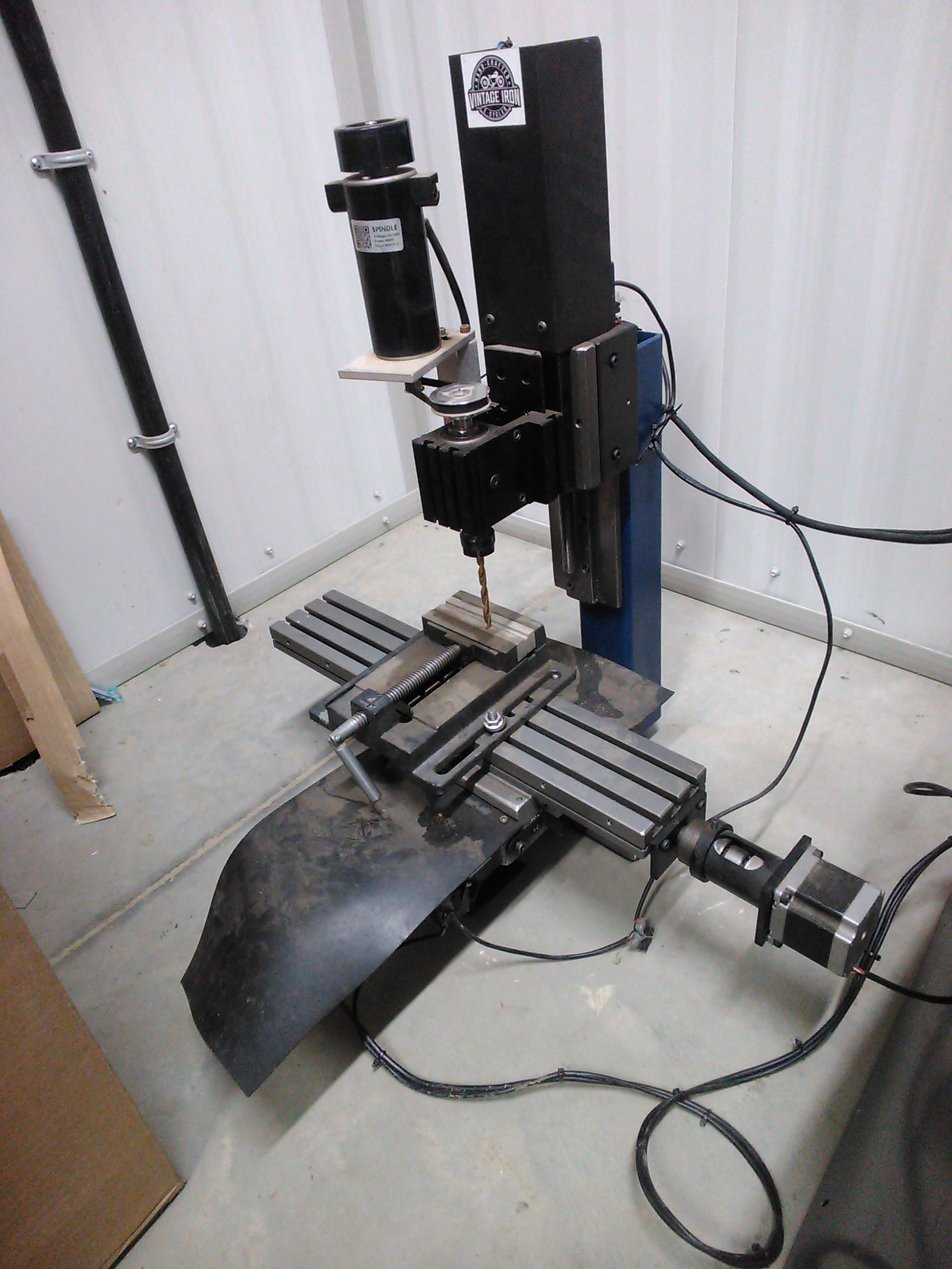

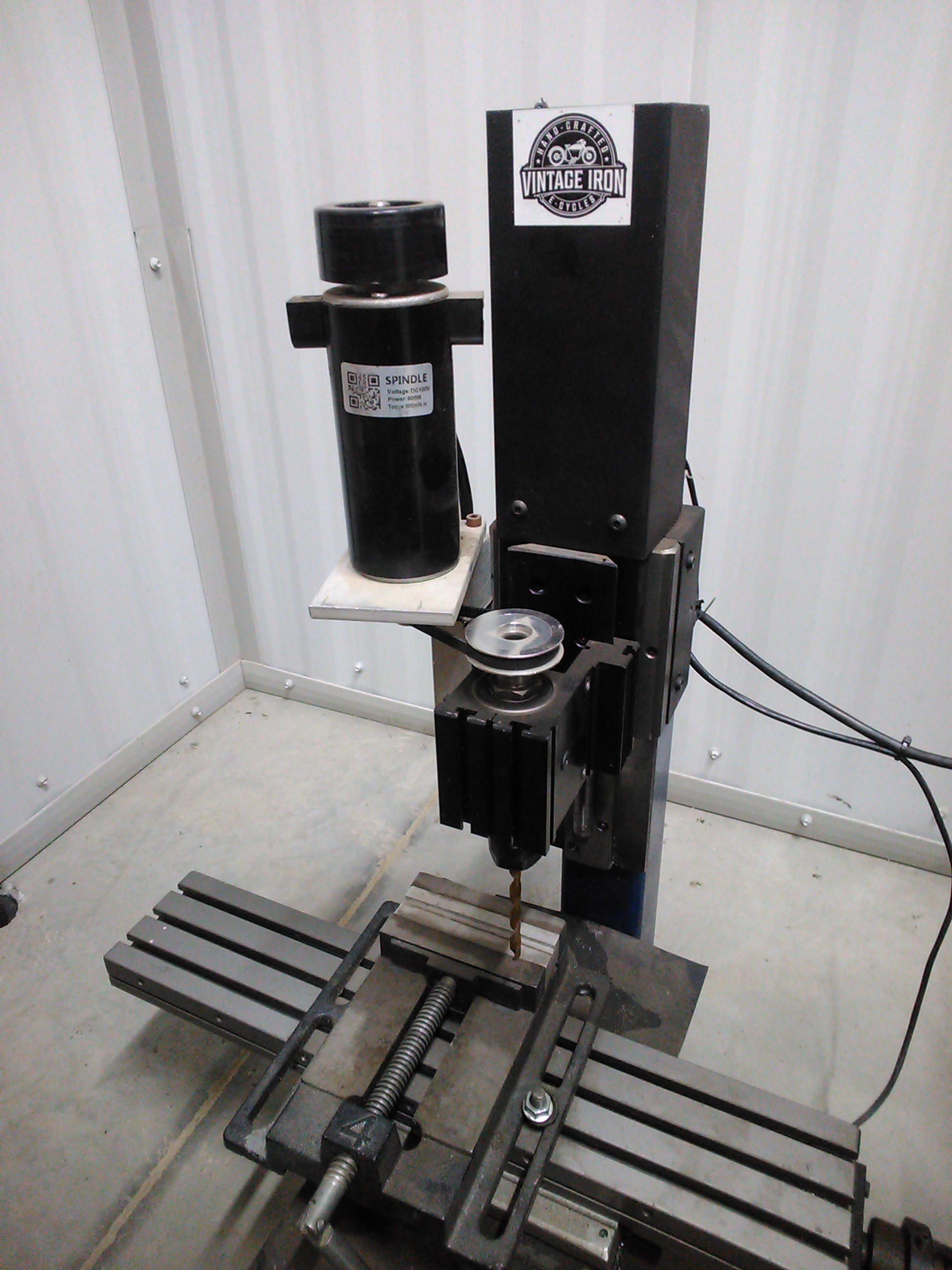

HiI got a small DIY milling machine from a friend who bought it from some guy a couple of years ago. When I plug everything in, Linux opens up, and I can jog the axis on the screen, the ini folder looks like it's set up, the controller turns on, but the motors don't jog even though they get warm. I'm wondering if there's some communication issue and where to start. I have run a foam cutter with Linux and know the tiniest bit about this, but not sure where to start diagnosingHelp is appreciatedThanks
- Posts: 18122
- Thank you received: 5337
27 Jun 2024 22:45 #303953
Replied by PCW on topic controller and motors not fully communicating
I would do some simple electrical checks
like seeing if the direction signals going to
the step drives change from 0 to 5V
(or vice-versa) when you jog in opposite
directions.

I know it's been months since I did my last post but i've been fiddling with this thing in my spare time. just to clarify, I have a Probotix box with motors, which I plugged into the computer running the mill and I could jog those motors. when I checked the voltages to the motors on the control box thats not working, I found the red and black have 22ish, the white and gray have the same but when I jog it doesn't change. What brings that signal to the driver. Thanks

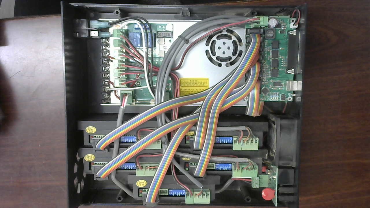

15 Oct 2024 22:20 #312218
by foam man
Replied by foam man on topic controller and motors not fully communicating
In this box?
- Posts: 22043
- Thank you received: 7506
16 Oct 2024 08:50 #312266
Replied by tommylight on topic controller and motors not fully communicating
That is a good controller, so what is not working on what controller?

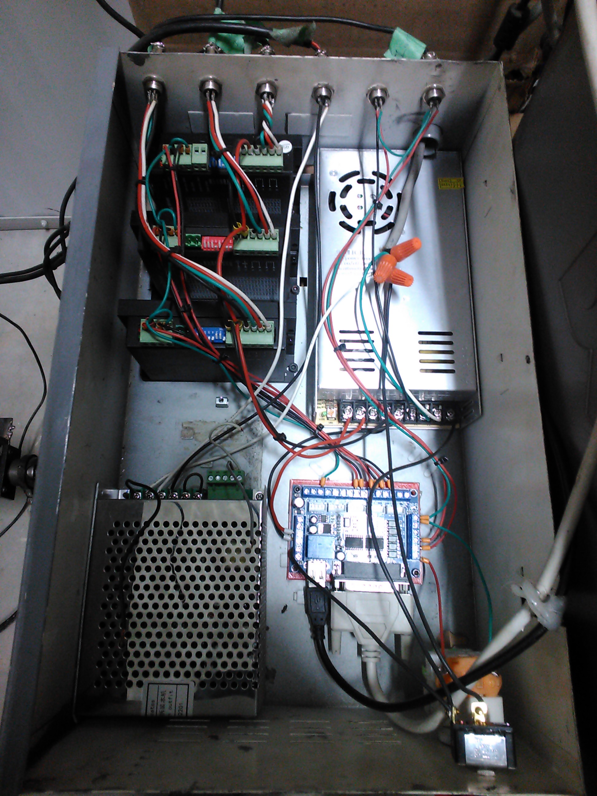

16 Oct 2024 11:48 #312278
by foam man
the Probotix controller works well, it's the other one (The first pictures) that does not work. the wires coming to the motors are getting power but the voltage does not change when I try to jog. I'm wondering if whatever wires bring the move signal are not doing their job. Originally I thought maybe it was a programming error, but if the Probotix box works...
