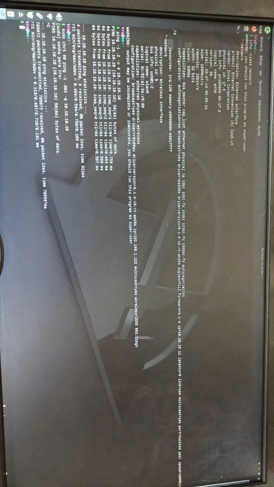

Hello guys
i am getting some errors related to stopping the movement of the axis suddenly with a Error Finishing read and joint following error although I have a 2000000 servo period.
is there anyway can I improve my ini file to get over this?
would it be ok to increase servo period further?
thank you
thank you

Other things to check:
1. Do you have an Intel or Realtek Ethernet chip?
( there are chip specific things you can do to improve latency)
lshw -class network
Will list your Ethernet (and wireless) network hardware if you are not sure
2. Have you run a simple ping test like:
ping -i .2 -c 4 10.10.10.10
sudo chrt 99 ping -i .001 -q 10.10.10.10
The first command populates the ARP cache so the ARP lookup doesn't add time to the first ping
The second command should be run for a few minutes (and then stopped with a control C)
and the results posted here.
lshw -class network

Hello.
to update:
this error happens specifically when torch is about to fire, it even fires for a millisecond before error occurs.
im using output2 on 7i96s to drive a relay. The relay closes circuit of torch on terminals on the generator.
attached is the output of those commands
to update:

The ping times are pretty bad.
If you have an intel Ethernet chip have you disabled IRQ coalescing?
This is described in the hm2_eth manual page:
man hm2_eth
gnipsel.com/linuxcnc/debian-12-eth.html
If you get the error right when the torch starts, that suggest a EMI
or grounding issue . Do you have a flyback diode across the relay coil?
man hm2_eth
Last edit: 05 Jul 2024 10:27 by PCW.

i have made the changes to the static IP and now i have a much smaller latency (about 0.100, 0.150)
i can "torch pulse" how many times i want and it will never have problems with the plasma ON.
i even have done "torch pulse" piercing the material, moving left, piercing again with torch pulse, etc.
i can run the G-Code how many times i want, without any problems, with "torch OFF".
i can run the G-Code how many times i want, without any problems, with "IGNORE OK", and "TORCH ON", and the plasma source itslef OFF, so the relay fires but there's no arc.
if i have "torch ON", and the plasma source ON, when i run a g-code, it will pierce the first time, and at the second time to pierce, it will give me a joint following error and "Error finishing read! Iter (...) "
my next attempt is to replace the mesa board and the relay..

Replied by tommylight on topic Error finishing read! Iter and joint following error in Stepper machine
Not a Mesa issue.
Wiring/shielding/grounding issue.

18 Aug 2024 11:49 #308089
by Lcvette
Replied by Lcvette on topic Error finishing read! Iter and joint following error in Stepper machine
ran this test, how does this look?Other things to check:
lshw -class network
xk7130@xk7130:~$ sudo lshw -class netork
[sudo] password for xk7130:
xk7130@xk7130:~$ lshw -class network
WARNING: you should run this program as super-user.
*-network
description: Ethernet interface
product: Ethernet Connection (2) I218-V
vendor: Intel Corporation
physical id: 19
bus info: pci@0000:00:19.0
logical name: enp0s25
version: 00
serial: d0:50:99:5c:61:57
capacity: 1Gbit/s
width: 32 bits
clock: 33MHz
capabilities: bus_master cap_list ethernet physical tp 10bt 10bt-fd 100bt 100bt-fd 1000bt-fd autonegotiation
configuration: autonegotiation=on broadcast=yes driver=e1000e driverversion=6.1.0-13-rt-amd64 duplex=full firmware=0.1-4 ip=10.10.10.11 latency=0 link=yes multicast=yes port=twisted pair speed=100Mbit/s
resources: irq:26 memory:efc00000-efc1ffff memory:efc34000-efc34fff ioport:f080(size=32)
*-network
description: Wireless interface
physical id: 11
bus info: usb@2:11
logical name: wlx5ca6e641710d
serial: 5c:a6:e6:41:71:0d
capabilities: ethernet physical wireless
configuration: broadcast=yes driver=r8188eu driverversion=6.1.0-13-rt-amd64 ip=192.168.1.197 multicast=yes wireless=IEEE 802.11bgn
WARNING: output may be incomplete or inaccurate, you should run this program as super-user.
xk7130@xk7130:~$ ping -i .2 -c 4 10.10.10.10
PING 10.10.10.10 (10.10.10.10) 56(84) bytes of data.
64 bytes from 10.10.10.10: icmp_seq=1 ttl=64 time=0.226 ms
64 bytes from 10.10.10.10: icmp_seq=2 ttl=64 time=0.150 ms
64 bytes from 10.10.10.10: icmp_seq=3 ttl=64 time=0.149 ms
64 bytes from 10.10.10.10: icmp_seq=4 ttl=64 time=0.150 ms
--- 10.10.10.10 ping statistics ---
4 packets transmitted, 4 received, 0% packet loss, time 609ms
rtt min/avg/max/mdev = 0.149/0.168/0.226/0.033 ms
xk7130@xk7130:~$ sudo chrt 99 ping -i .001 -q 10.10.10.10
^C
355710 packets transmitted, 355710 received, 0% packet loss, time 355709ms
rtt min/avg/max/mdev = 0.077/0.122/0.330/0.009 ms
xk7130@xk7130:~$ Please Log in or Create an account to join the conversation.
- Posts: 18122
- Thank you received: 5337
18 Aug 2024 12:46 #308096
Replied by PCW on topic Error finishing read! Iter and joint following error in Stepper machine
Looks decent (no huge ping times)
