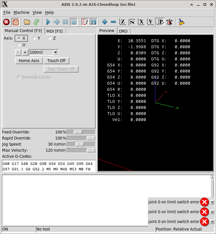

Clearing error messages - without a bunch of mouse clicks

Axis GUI should have hal pins to clear messages:
See section 13:
linuxcnc.org/docs/html/gui/axis.html#_keyboard_controls
Type Dir Name
bit IN axisui.notifications-clear
bit IN axisui.notifications-clear-error
bit IN axisui.notifications-clear-infoSee section 13:

Replied by COFHAL on topic Clearing error messages - without a bunch of mouse clicks
I used the axisui.notifications-clear-error bit pin with oneshot. They must be loaded in a postgui file, with this option the error message appears on the screen for the time determined by oneshot and then it is deleted

In axis: Ctrl + spacebar clears all the messages. This can also be used for OK in a tkinter message box or confirm toolchange window.

loadrt oneshot names=oneshot.GUI-ERROR
addf oneshot.GUI-ERROR servo-thread
setp oneshot.GUI-ERROR.width 2
setp oneshot.GUI-ERROR.retriggerable 0
net GUI-error axisui.error oneshot.GUI-ERROR.in
net BORRAR-ERROR-GUI oneshot.GUI-ERROR.out-not axisui.notifications-clear-error
Work for me.
