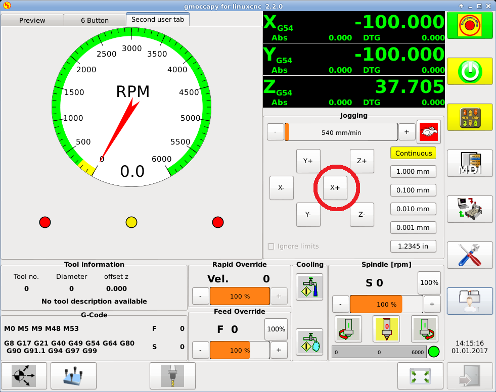

I added an attachment and a ring around the jog button I am talking about. So what you are saying is that I don't have to make a Hal pin connection from that jog button with a red ring, with a pin from the motion component, to make the jog button move a stepper motor?
In my mind I'm thinking something like
- net x.axis.jog gmoccapy.jog.axis.jog-x-plus => hm2_[MESA](BOARD).0.stepgen.00.velocity-cmd
- net x.axis.jog gmoccapy.jog.axis.jog-x-plus => joint.0.motor-pos-cmd

The jog information goes from the GUI or hardware (MPG, Buttons etc)
to motion. Motion takes care of things like bounding acceleration and velocity,
and obeying soft limits. All low level hardware joint motion passes through
LinuxCNCs motion component. At some point the jogging information from the GUI,
switches/MPG gets connected to motions joint and/or axis jog pins:
man motion
(search for "jog" = /jog)

An MPG or on screen jog button usually alters a count variable or pin up or down (plus or minus) and the count is scaled to steps per mm (or inch). That way the system knows how far the axis should move for every click of the MPG
This also explains why the count is not a float type
The jog velocity to use is set in an ini variable
That man pages eg man motion are also published to the Linuxcnc documents web site. I always use the web site. Just make sure you read the docs for your version of Linuxcnc.
The documentation for a component is actually coded into the component itself and extracted to a man page (and the web page) using halcompile when Linuxcnc is built
Keep it up. One day it will eventually click

Yes, typically all motion commands to lower level hardware come
from motions joint.n.motor-pos-cmd pins.
The basic jog information to motion uses motions jog pins like
axis.x.jog-counts and axis.x.jog-enable
The manual page and the HTML should be identical as they come
from the same source.

Most GUIs are written in python and use the Linuxcnc python API instead of connecting signals through hal pins:
linuxcnc.org/docs/devel/html/config/python-interface.html
Over time you will find that there usually are several possible ways to get something done in LinuxCNC.
