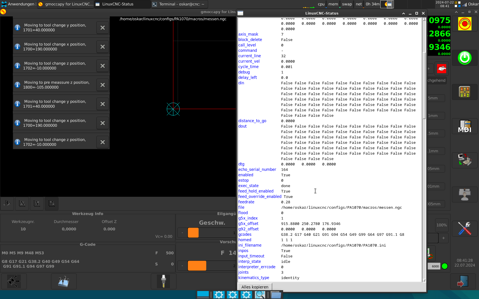

22 Jul 2024 01:50 - 22 Jul 2024 01:51 #305836
by Raksop
Replied by Raksop on topic LinuxCNC stalls on manual toolchange routine
I added some debug lines to the code and did the same procedure.
First tool call works and the machine stalls on the second tool call after the tool change is confirmed.
On the screenshoot u can see that the machine called the toolchange macro.
Last edit: 22 Jul 2024 01:51 by Raksop.
