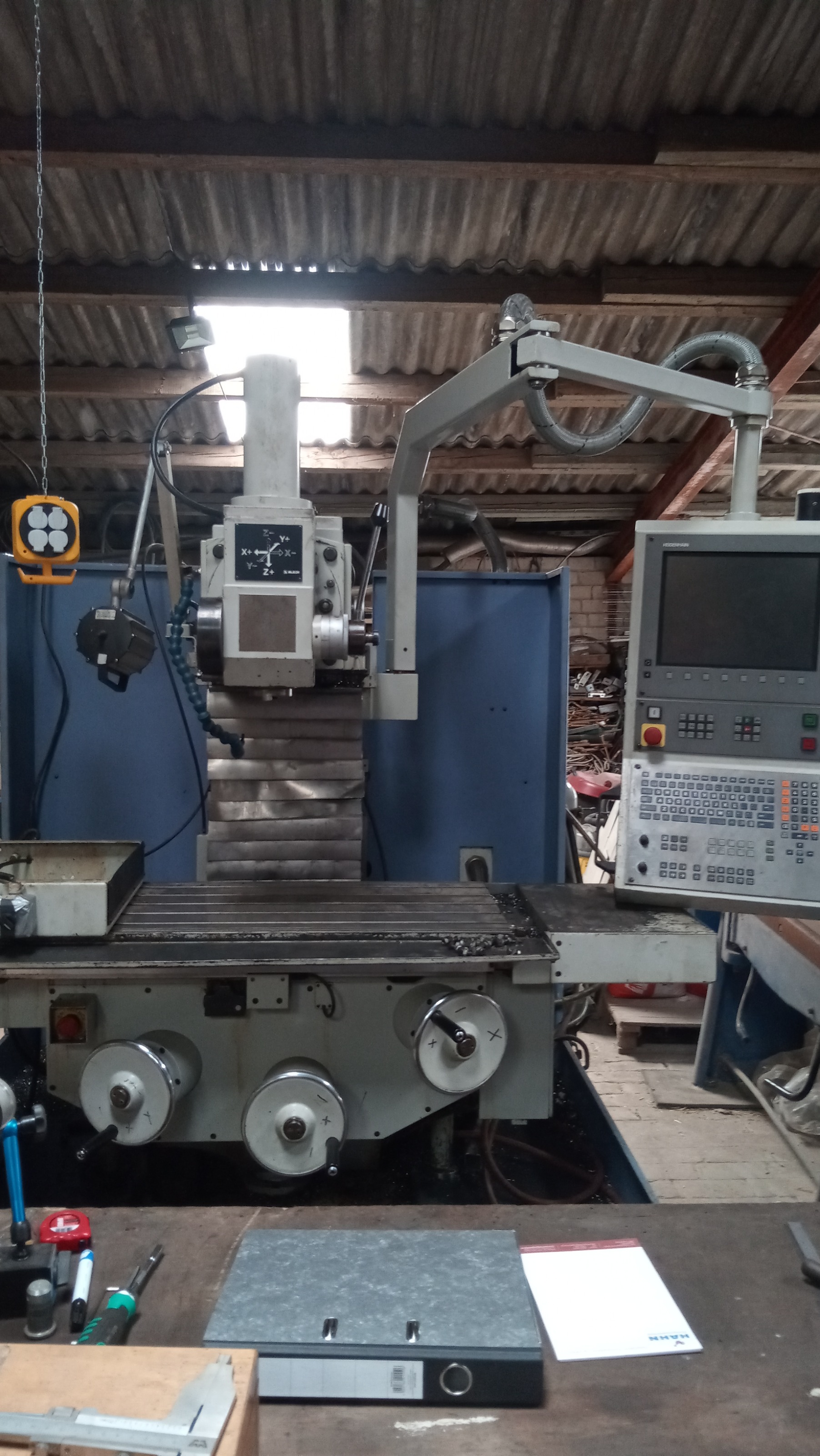

I´m Matthias from Germany and have recently bought a used CNC-Mill with a defective Heidenhain iTNC530 control. After a long call with the really supportive folks at Heidenhain there are a few easy tests left for me to run, but everything seems to point to a fault in the control's hard drive. In that case I would not only need a new hard drive but also the parameter list from the manufacturer.
However I am not enclined to spend much time and money on this "old"(2005) controller and have another fault in half a years time. If the control ran fine i would be more than happy to use it.

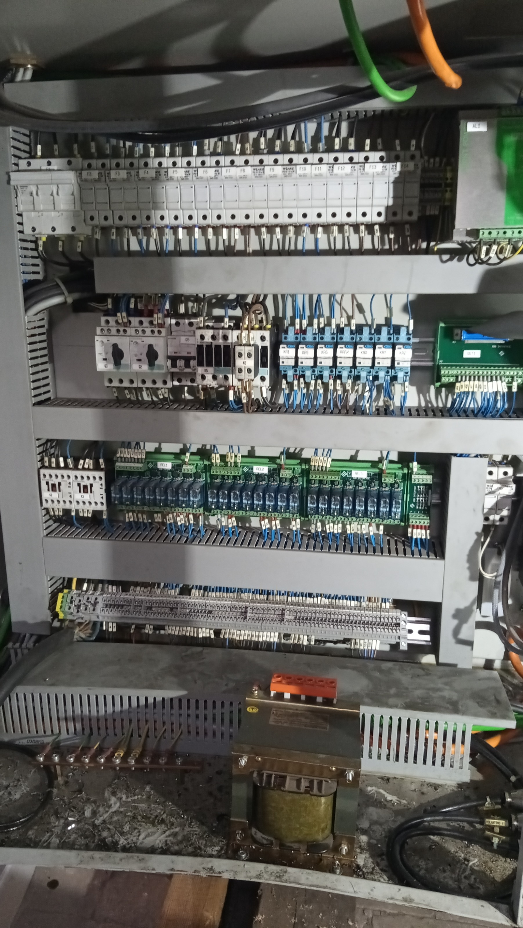

At first glance into the control cabinet the electronics are all in good order and working condition. The big drives for the servos and spindle appear to be functional and it does not look like someone tried tinkering with the machine before. As I understand it, this machine was sold new to a company which then used it until it faulted out and some time after the company went bankrupt and sold the shop with the machine. Now the new owner of the shop has no interest in this non running machine which is why i got it for a good price considering the mechanical state of everything.

-Reuse of all motors and drivers (3 axes, 1 spindle, speed control only with vfd, no gearbox)
-Reuse of the Heidenhain monitor and keyboard (if that is feasable and someone knows how to do it)
-Control of other systems like lubrication and hydraulic pump should be no issue as I see it
As this would be my first retrofit and I have no experience with linux or linuxcnc a lot of hand holding will be required. However I am willing to invest a lot of time and effort into this machine. I hope i can get away with buying only a computer and the Mesa cards, but not any servo drives or other high load components.

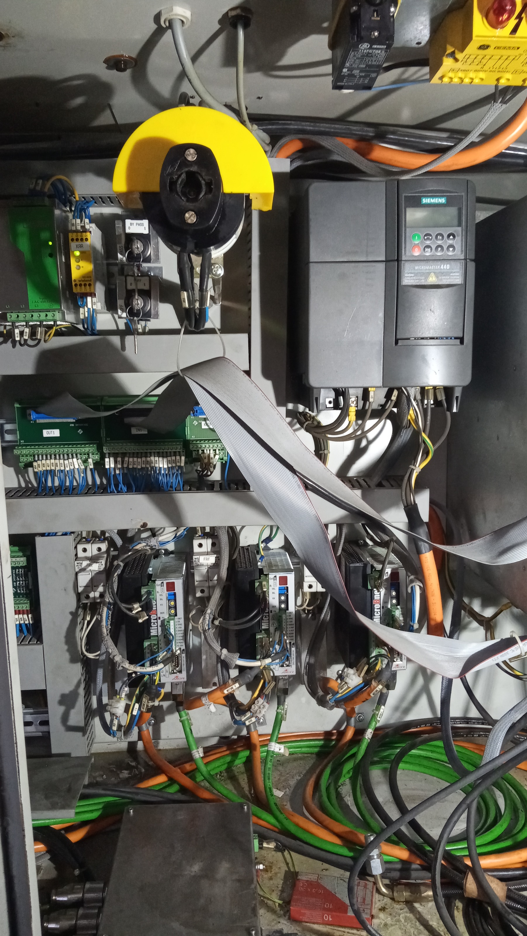

Most important question is what motor drives does the machine use (ie for axis motors and for the spindle). If the current drives accept either analog or step/dir signal then they are usually fine for a refit. If they use some kind of serial interface then things get difficult.

The drives use an analog signal from the control. I was also able to find datasheets and the software to tune these drives online.

If the drives are analog +-10V, then in this order
Mesa 7i97
Mesa 7i92TM + 7i77
Mesa 7i92TM + 7i85 + 7i83 + 7i84
Mesa 7i96S + 7i85 + 7i83 + 7i84
