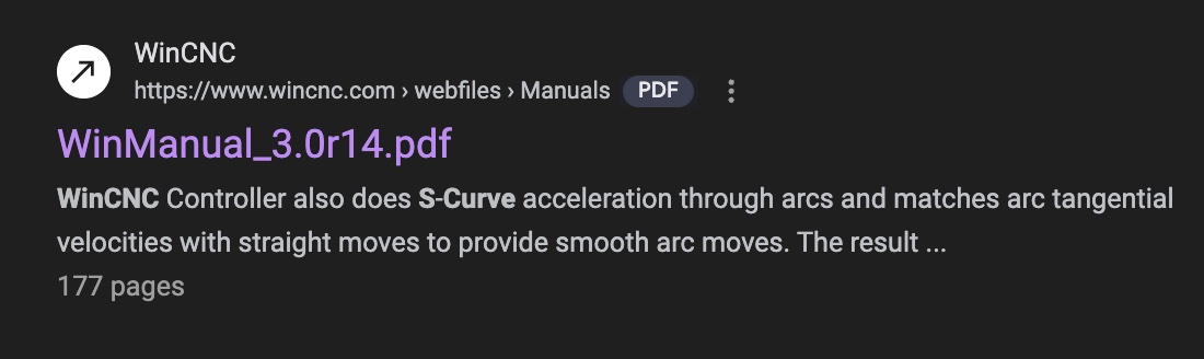

- warreng
- Posts: 11
29 Aug 2024 18:36 #308990
by warreng
Replied by warreng on topic 5x10 servo router rebuild - analog of step/dir with mesa card?
My googling shows hints that WinCNC has some s-curve support. But I'm not educated enough to know how complete or useful it is. Thank you for the first hand comments about WinCNC.
Your comment about jerk limiting in the servo highlights a hope I had wrt the Yaskawa drives I have. But, alas, Sigma II doesn't appear to have this feature. I'm also confused about how a machine can keep synchronicity while drives are doing acceleration modifications in isolation.
If I've read correctly, you are running primarily wood cutting machines?
