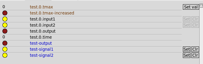

Hi all! I need to write a component that could control the spindle gearbox shifting depending on the revolutions, but since I am a beginner, I first want to create a simpler component. The job of this simple component is to set the output to TRUE if both inputs are TRUE. To check, I use HALSHAW, I change the signals at the input of the component, but the output does not change, what am I doing wrong?

I found the reason, it was necessary to add my function to the thread.
