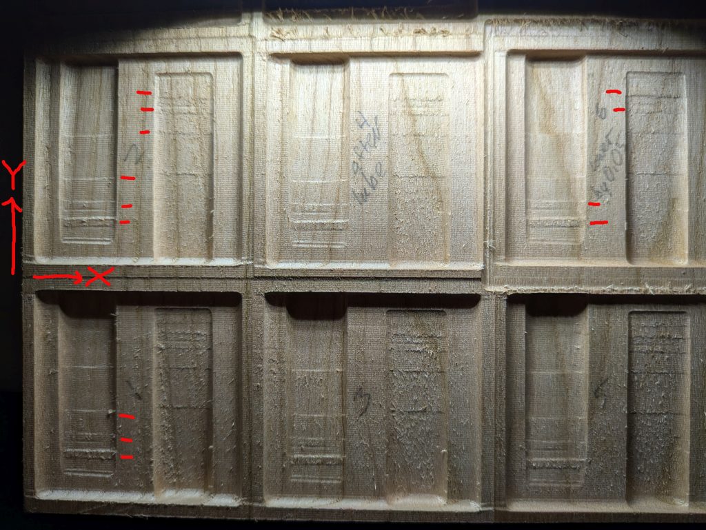

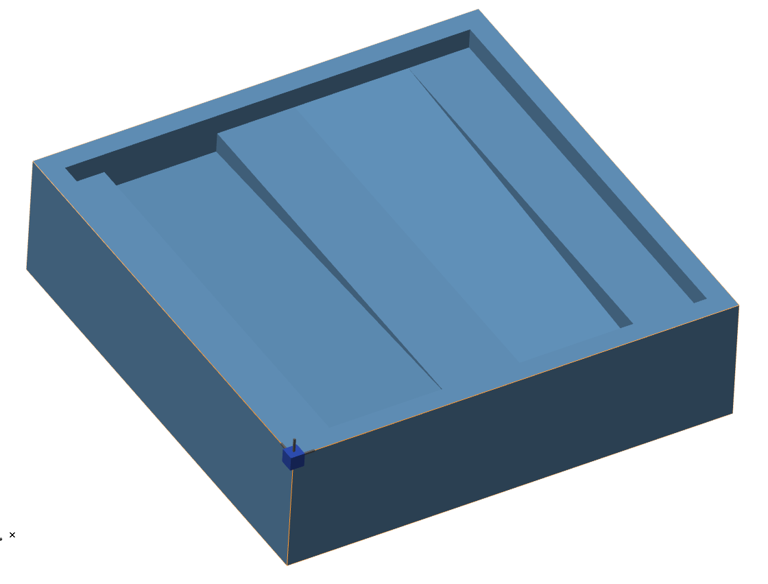

Summary: For test purposes (for this problem), I'm cutting two ramps, one up, one down, in a 2" square. A lot of the resulting ramps are smoothly surfaced, but there are places where the z level is incorrect, leaving a raised area. I'm thinking it isn't hardware because the same error pattern repeats: ramp up/ramp down, moving the test pattern in Y, moving it in X, and changing the Z level (using thinner stock). The pattern repeats across all these conditions. I am at a loss. Software sounds likely, but there is no sign of the errors in simulation.
My machine: home built, open loop steppers, Gecko 540 drivers at 48V. Ball screws XY, Z is currently a fast lead screw. LinuxCNC/Axis, DeskProto CAM. I use a Bosch 1617evs router, it is cutting with a tapered ball nose bit, end diameter 1/8".
This very likely is not a LinuxCNC problem, but in my experience, this forum has some very sharp and responsive people on it. I've been working on this for a month.

What happens when you run the finish pass along the y direction?
Have you run the code with a tighter g64 like .005" or .001"?

I don't think it is a machine problem. Running it in sim and going block by block, Z is not reaching end point and ramping across the cut. I did not find a change of M code in the area of code. It could be a DeskProto CAM problem, but this is just a guess.

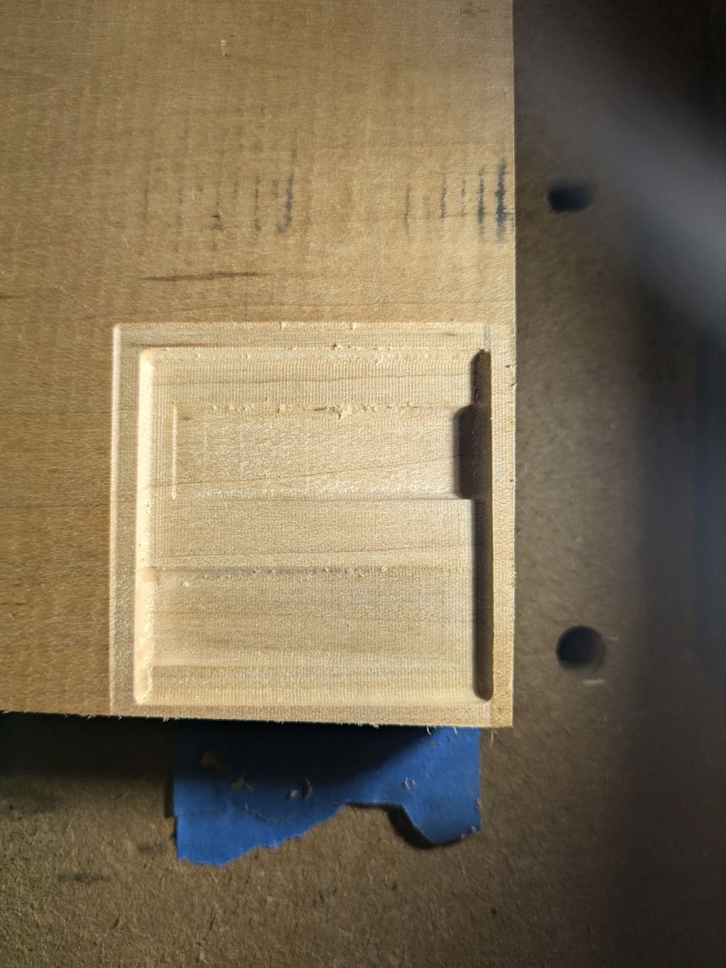

OT-CNC, immense thanks. G64 at 0.001 helped a lot. I've improved the carve a fair bit during the past month, but this takes things the last (large) step. I started trying to carve a topo, it looked awful with machine marks.

The picture didn't post for G64 0.001, I forgot to resize it. Here it is.
- Posts: 22043
- Thank you received: 7506
30 Aug 2024 16:52 #309056
Replied by tommylight on topic I don't think it's a hardware problem
Looks much better now.
