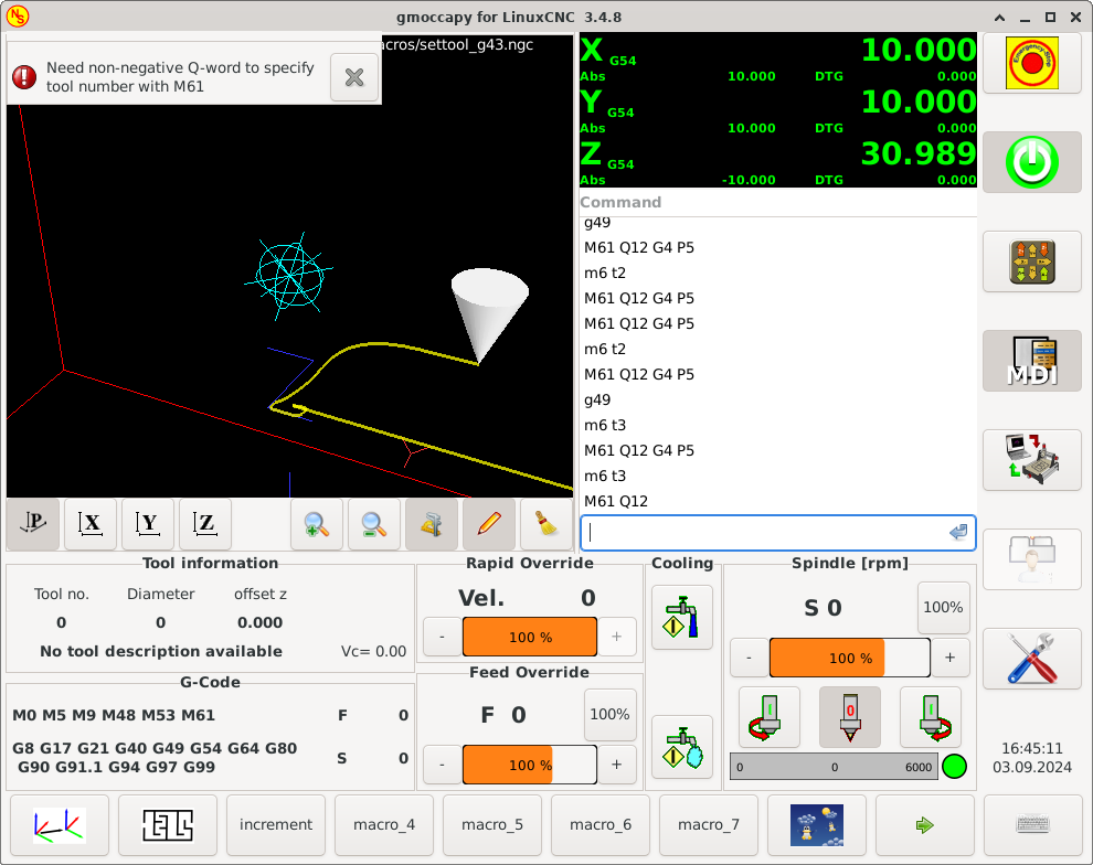

Hello,
I work on AUTOMATIC_G43 by remap. I use master branche (2.10) RIP instalation.
I added in INI file:
Remaps M6 works as I need but remap M61 doesnt.
I tested it in Gmoccapy and in AXIS.
Can anyone guess where the error might be?

LOG_LEVEL = 8o<change_g43> sub

M2o<settool_g43> sub
;(debug, tool=#<tool> pocket=#<pocket>;)
; we must execute this only in the milltask interpreter
; or preview will break, so test for '#<_task>' which is 1 for
; the milltask interpreter and 0 in the UI's
O100 if [#<_task> EQ 0]
(debug, Task ist Null)
O100 return [999]
O100 endif
; using the code being remapped here means 'use builtin behaviour'
M61
; set tool offset
G43
; signal success be returning a value > 0:
o<settool_g43> endsub [1]

- Posts: 4819
- Thank you received: 2177
03 Sep 2024 10:50 #309295
Replied by Aciera on topic Remap M61 doesnt work
in your 'settool_G43' sub you have this:Seems to me that you are missing the required 'Q' word here.
M61
- zz912
- Posts: 596
- Thank you received: 98
03 Sep 2024 11:09 #309296
by zz912
Replied by zz912 on topic Remap M61 doesnt work
I did not find example of right use M61.
I use remap with M6 and I dont need 'T' word.
Here is definition for minimal M6/M61/T/S/F
linuxcnc.org/docs/devel/html/remap/remap...cluding_code_m6_code
