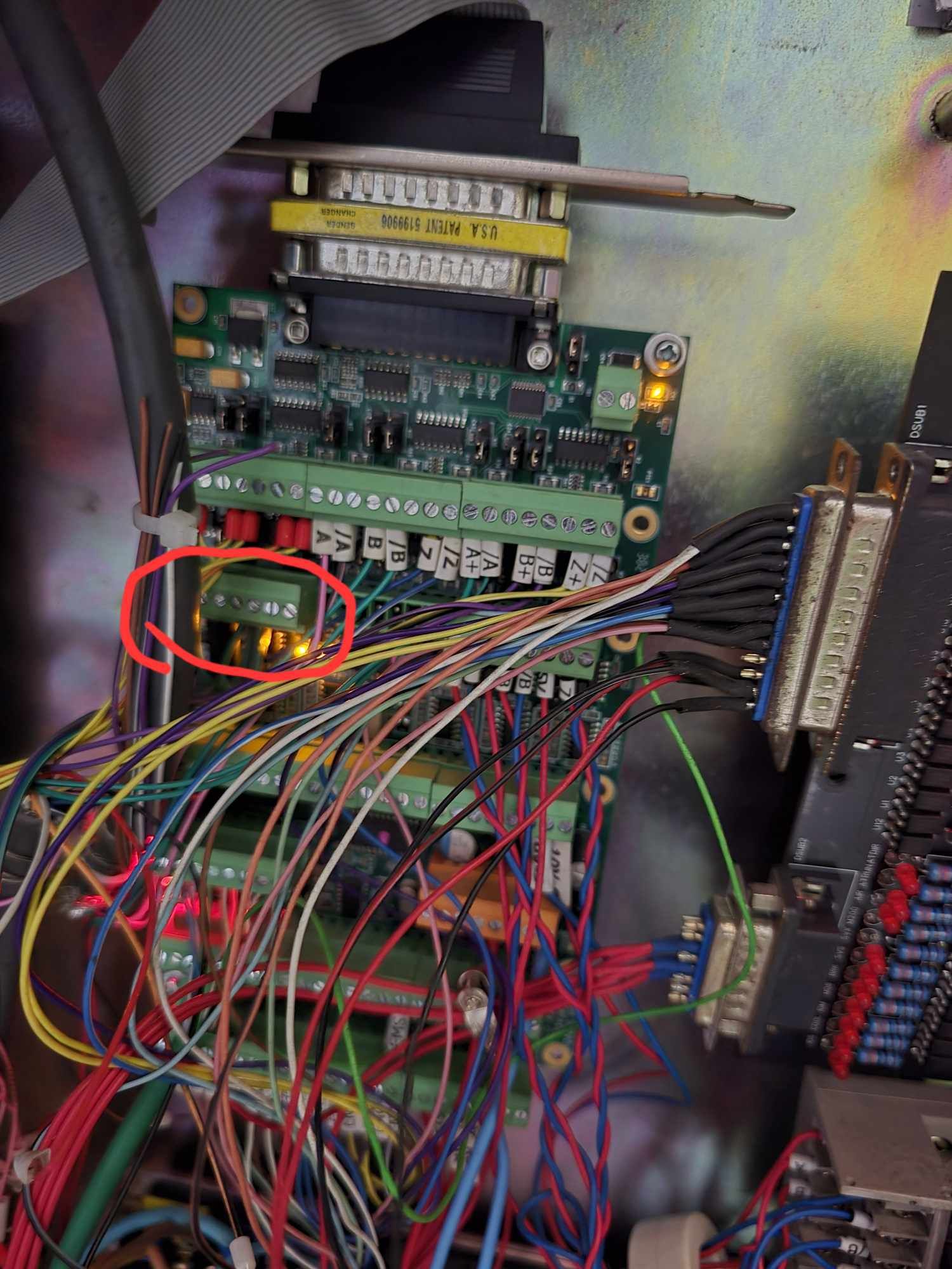

Hi
I use 7i77 for feedback control with encoder motor signal succesfully
Now I try use feedback with linear scale for Y axis

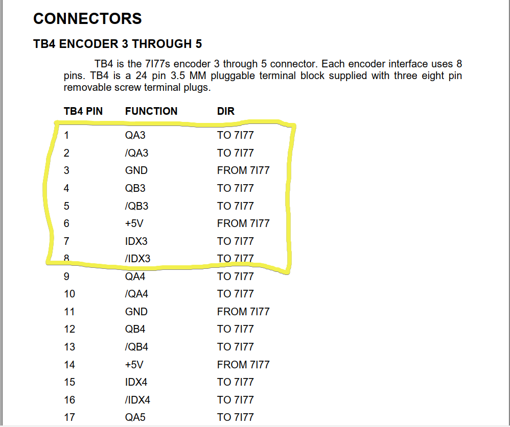

I wiring TTL signal from linear scale A signal, B signal to Encoder 03 slot (TB4 terminal)
I can open Gmoccapy but when JOG DRO of Y axis not change i think problem from linear scale
I have question ,TTL can work with 7i77 ?

TTL should work with Mesa 7i77, so check the hal file and make sure Y axis is using encoder.03.
Also, just in case, encoder.03 is the 4'th encoder connector on Mesa, the enumeration starts from 00.

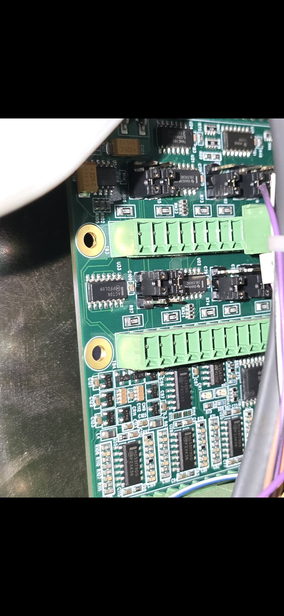

You also need to make sure that the 7I77 encoder inputs are jumpered for TTL mode.
For encoder 03, this means jumpers W18,W20,W22 must be in the left hand position.
(default is differential mode = right hand position)

Ah.... I'm not sure about Jumper W18 W20 W22 Tomorow will let's check again Thank you MR.PCW

That will be "single ended" encoder or glass scales, usually 4 wires for A,B and power, or 5 wires if they have index.
7i77 is factory set for "differential" mode, meaning each signal has two wires and two for power, so usually 8 or 10 wires, although all i have worked with are 10 wire type.
