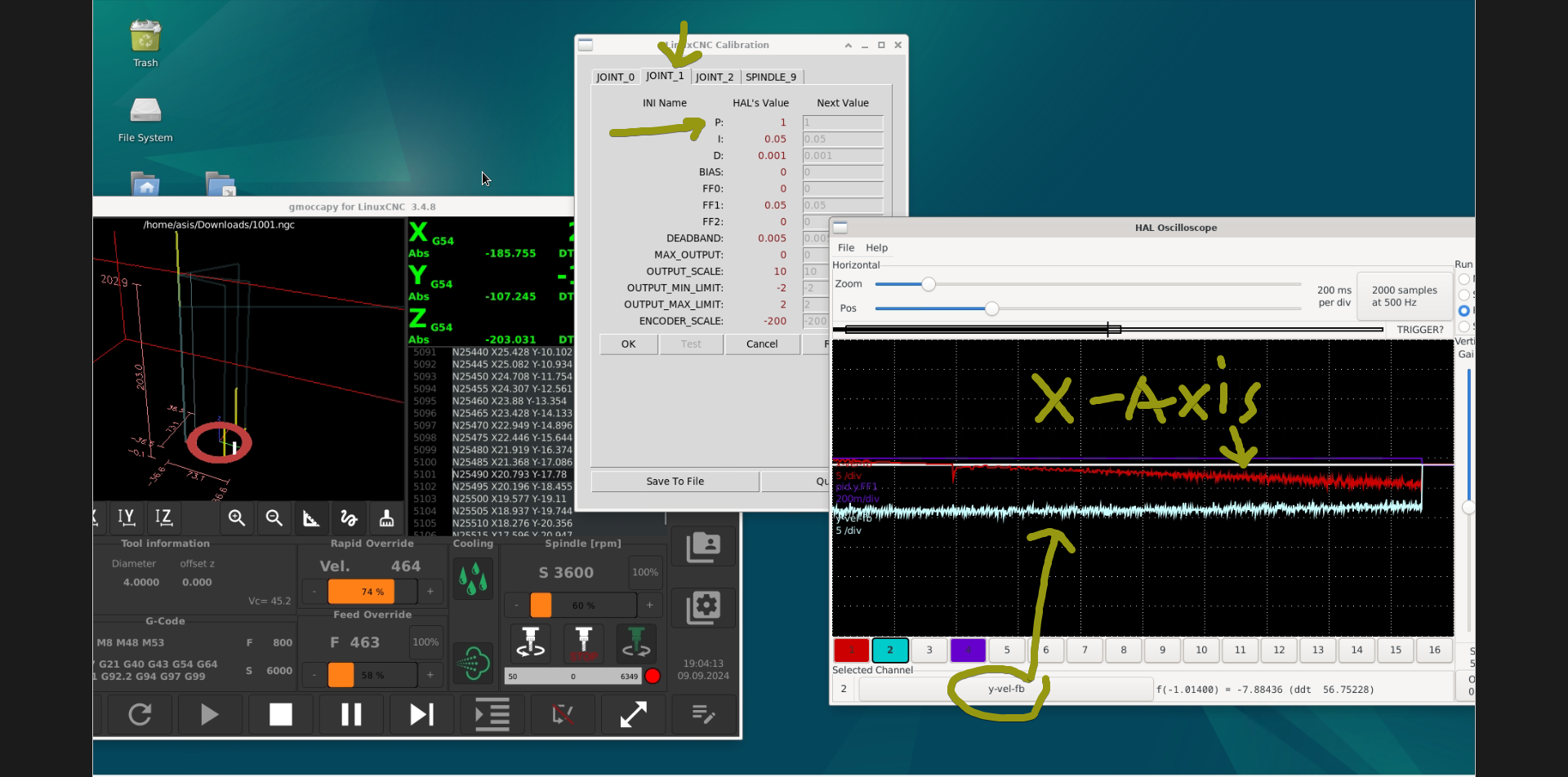

I config , setup , Tunning for Analog to Servo DELTA A2 (I use analog from 7i77) 2days I can't smooth tunning Servo motor (I check with Hall scope with signal x-vel fb , y-vel fb)
I read tunning from MR.Tommy
forum.linuxcnc.org/10-advanced-configura...mple-mesa-7i77#88210

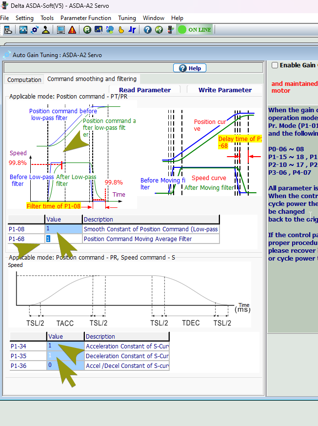

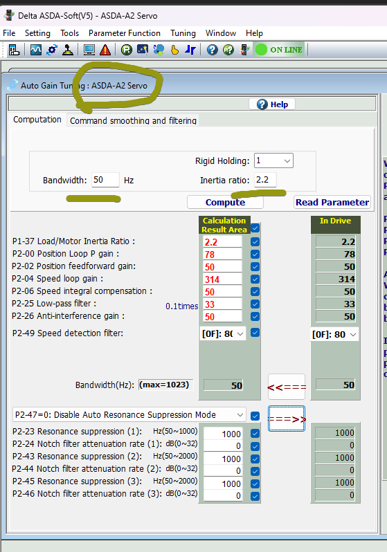

and see picture ,He can P = 20 but me 1 - 1.5 only .
when P = 2 my servo super vibration and cut .
Servo DELTA A2 other config or setup ? can advice me ?

If the drives are not tuned properly to the motors they are using, no ammount of tuning in LinuxCNC will help.
Normal procedure for tuning analog drives is to tune the torque mode first with motor not attached to machine, then do velocity loop tunning in drive, and if drives have position mode also tune this.
Only after tuning drives to motors you can procees to tune in LinuxCNC, just do not forget to set the drive in velocity mode after testing position mode, if any.
