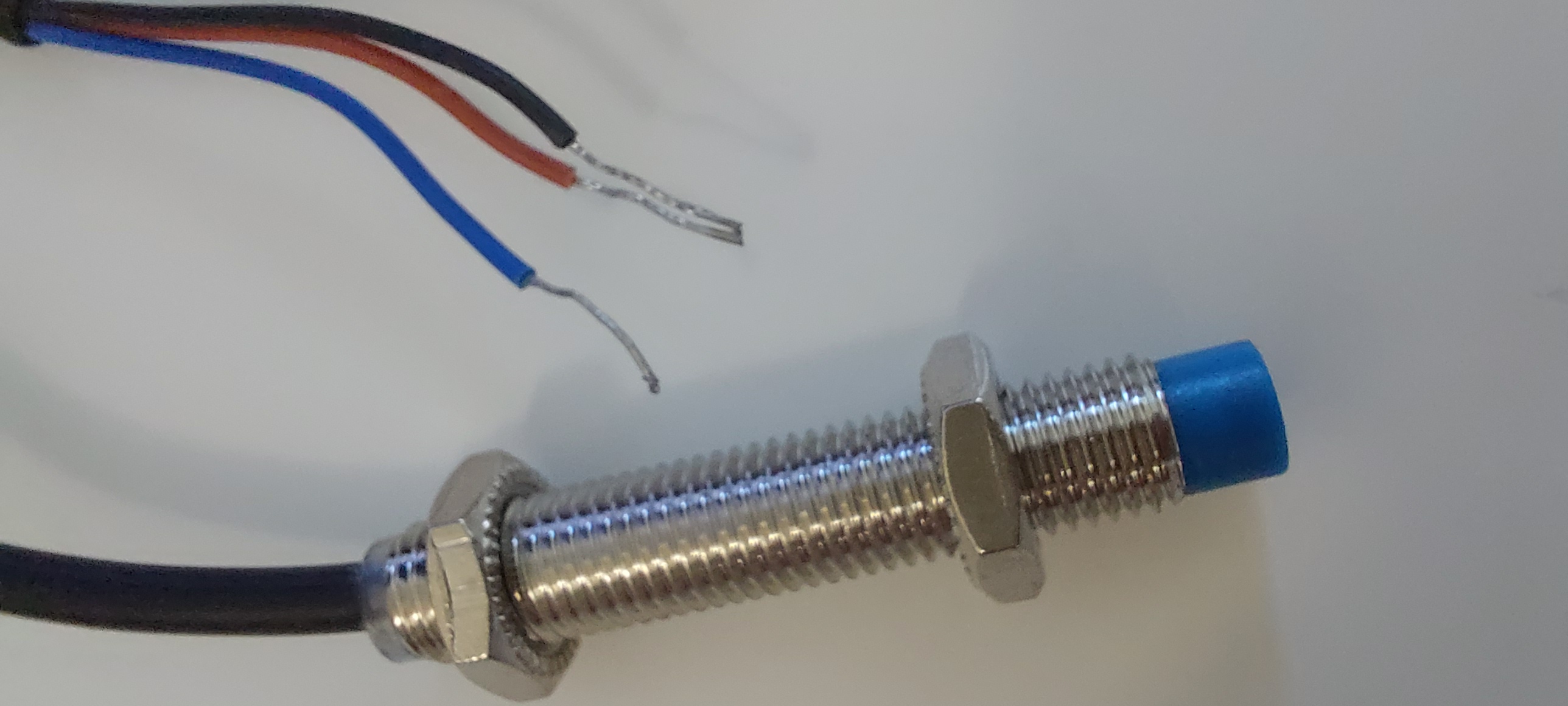

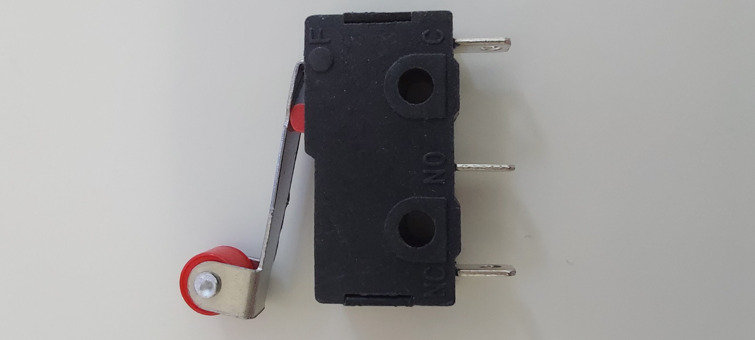

Good evening, I am assembling a CNC electronics with a mesa 7i96 board and should wire three NPN/NC inductive sensors (LJ8A3-2-Z/AX) as homing sensors and six NC mechanical microswitches as limit sensors. Could anyone tell me how to wire the sensors to the board and the 24v PSU?
I attach photos of the sensors.

For NPN sensors you wire the 7I96 input common (TB3 pin 12) to +24V
Also for NC home/limit sensors you must invert the inputs
