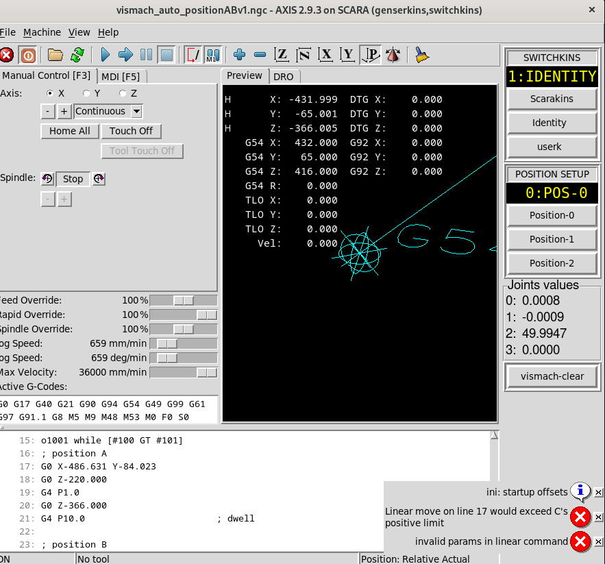

Hello,
My system is:
- LCNC 2.9.3, Debian 6.1.0-22-rt-amd64
- EtherCAT AC servo
- Everything is ok: homing, moving each axis separately, ...
When I run G-code, I have strange error: "Linear move on line xxx would exceed C's positive/negative limit".
I remember that it was ok with LCNC 2.9.2, but I have trouble with LCNC 2.9.3
I did big number of MIN & MAX Limit, but could not run G-Code.
Any advise ?. Thank you.
My system is:
- EtherCAT AC servo

I'm not familiar with 'scarakins' but looking at 'configs/sim/axis/vismach/scara/scara.ini' and comparing that with your 'tsino_scara_3ax.ini' it seems to me that you have not configured enough joints:

Hi Aciera,
Yes, correct, I copied scara.ini from vismach demo and revised it.
Actually there are 3 joints (J0, J1, J2) which are most useful in SCARA application. That's why I only test with 3 joints and removed 3 joints (J3,J4,J5)
Is it root cause to have this error ?. should it be ?.
Thank you.
Thank you.

Problem is that the kinematic model in scarakins.c is for a scara with 3 angular joints and a linear joint and also two angular joints that move the table. You could easily remove those last two (ie j4/a and j5/b) from the kinematic as they are just looped through. J3/c however is part of the calculation so to remove that you will need to have a closer look at the forward and inverse kinematic model.

Hi Aciera,
You are correct. I added joint-3 and it worked
I see another issue of "tk window".
As my testing, I test moving from position-A to position-B in 200 times.
Normally after 50th time, the "tk window" is freezing, although G-code and real motors are still running.
Have you faced this issue ?.
Thank you.
Thank you.
