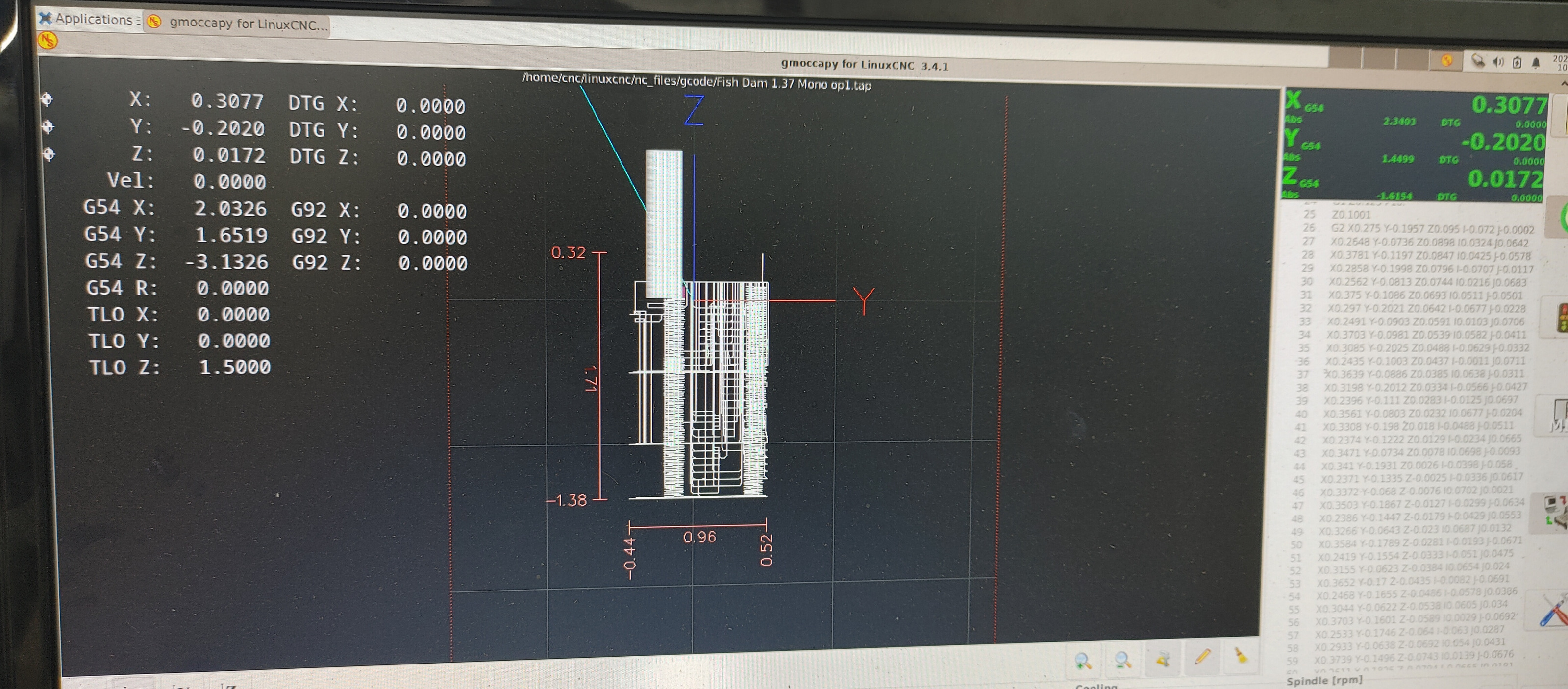

19 Sep 2024 18:12 - 19 Sep 2024 18:13 #310482 by crazycajun
gmoccapy z height after hitting start was created by crazycajun

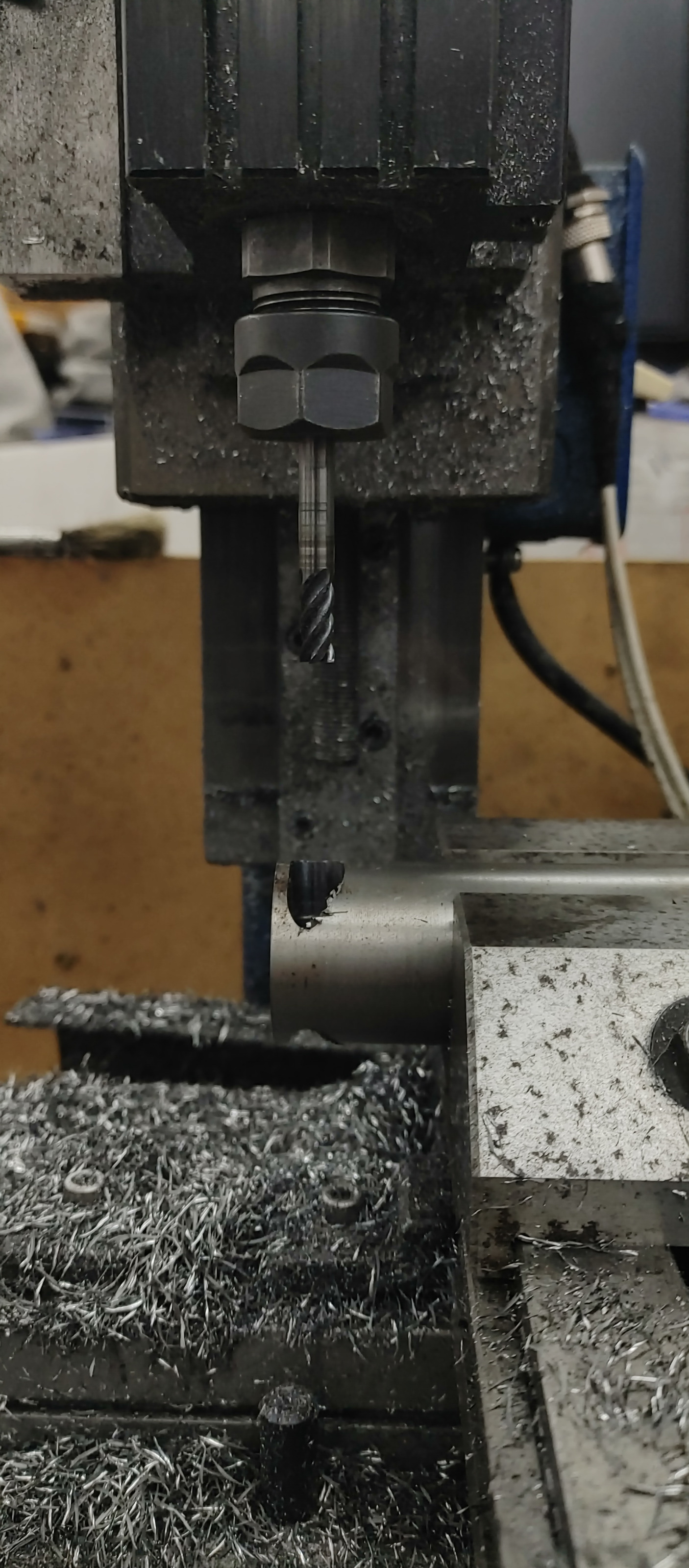

For some reason the tool is always way above the work. Every axis was zero, it homed Z, came down and its very high up. If i rezero Z again, it works as it should. Ideas?
Last edit: 19 Sep 2024 18:13 by crazycajun.
20 Sep 2024 00:43 #310490 by Aciera
Replied by Aciera on topic gmoccapy z height after hitting start
If you zero without G43 'TLO Z' will be zero and once you activate it then the controller will lift the spindle up by the tool length offset (TLO Z) which seems to be set to 1.5 (inches probably).
20 Sep 2024 06:36 #310505 by crazycajun
Replied by crazycajun on topic gmoccapy z height after hitting start
I did have a 1.5" offset added to tool 12, but took it off. Had the same issue still.
20 Sep 2024 07:49 #310508 by Aciera
Take a screenshot of the whole screen so we can see what G/M codes are active also if this happens when running gcode then please attach that as well. We're just poking around in the dark like this.
