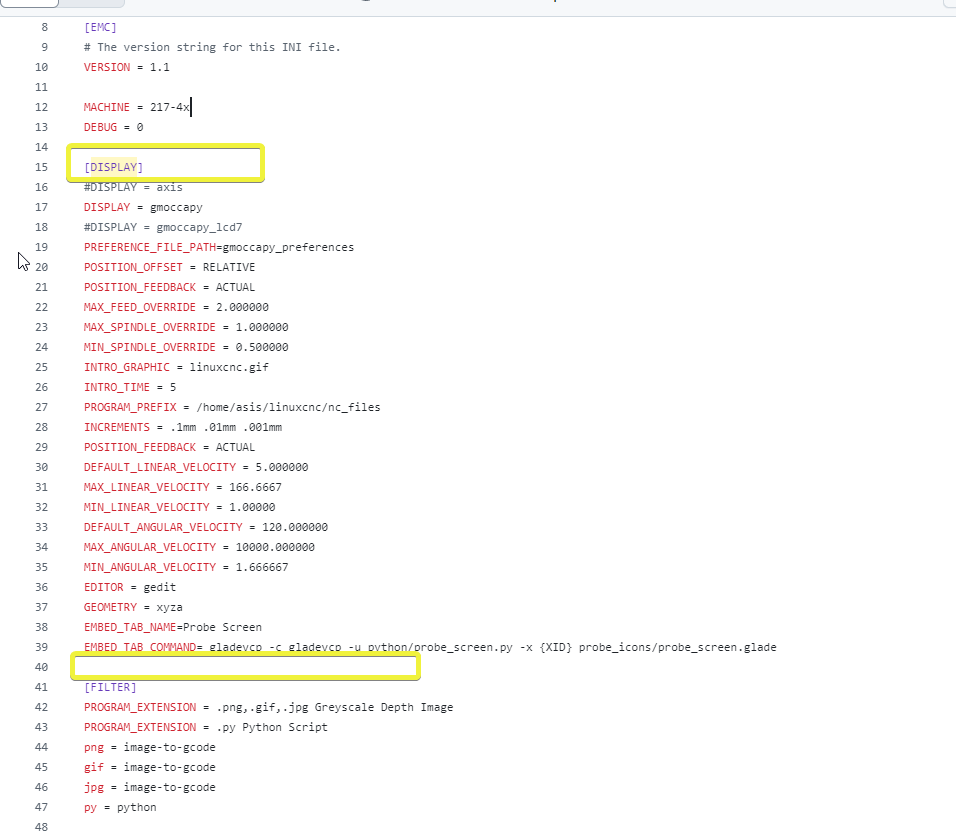

Hi
I use 7i73 for 8*8 matrixkey .
about 1-2 days this it's just have a problem when I push button sometime it's will close GMOCCAPY.
FYI: I use 7i73 matrix key over 2 month not found this problem before.
this below from terminal
How I can fix?
Full text linuxcnc terminal in attach file.
Thank you
Asis

[Gmoccapy.GMOCCAPY.GETINIINFO][WARNING] No DEFAULT_SPINDLE_SPEED entry found in [DISPLAY] of INI file (getiniinfo.py:282)
[Gmoccapy][ERROR] ERROR, trying to initialize the user tabs or panels, check for typos (gmoccapy:1806)
[Gmoccapy][ERROR] ['notebook_mode'] (gmoccapy:1807)
/usr/bin/gmoccapy:4586: DeprecationWarning: Gtk.StyleContext.get_background_color is deprecated
color = style.get_background_color(Gtk.StateFlags.SELECTED)
11:45:12.464 WARNING Config: mousetweaks GSettings schema not found, mousetweaks integration disabled.
float division by zero
[Gmoccapy.GMOCCAPY.GETINIINFO][WARNING] Wrong entry [DISPLAY] CYCLE_TIME in INI File! Will use gmoccapy default 150 (getiniinfo.py:56)

Do you have any matrix keys mapped to keyboard events?

The "float division by zero" looks worrisome. Do you see that in a sim config too? Or is it a problem in your own handler code?

Thank you for respond anddypugh .
I go to check my file backup in cloud , oh yes in .ini file group DISPLAY lose CYCLETIME [Gmoccapy.GMOCCAPY.GETINIINFO][WARNING] Wrong entry [DISPLAY] CYCLE_TIME in INI File! Will use gmoccapy default 150 (getiniinfo.py:56)
Tomorow i will try.

I have update
Today I try put CYCLE_TIME = 100 ingroup [DISPLAY] inside .ini file
Now "float division by zero" Not show error
And I check in hall show found some matrixkeys stuck all time .
I try knuckle button and light in hall show change to off, Now GUI not close when I push button and back to good condition work
I will found the stuck button and will change it's out for next time
7i77 good work not is bug thank you MR.andypurg
