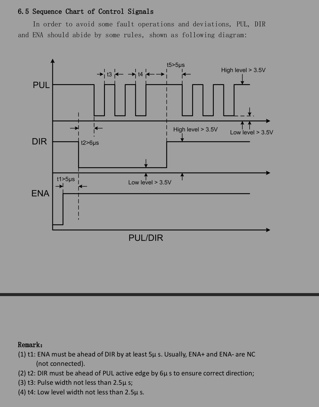

26 Sep 2024 16:14 #310858
by andreabonuc
Replied by andreabonuc on topic Constant loss of position
This is what indicate the manual for the servomotors jmc
- Posts: 18122
- Thank you received: 5337
26 Sep 2024 16:42 #310859
Replied by PCW on topic Constant loss of position
So the existing setup/hold times are marginal
I would set them both to 20000 (20 usec) as I
mentioned before.
mentioned before.
