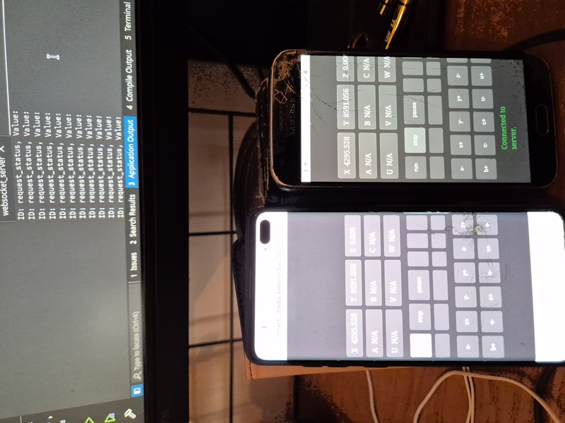

Hi all.
I am almost ready with a project to communicate from and to linuxcnc trough websockets
to exchange realtime io.
In other words, interact with a running linuxcnc machine from a remote webbrowser.
Linuxcnc can be controlled remote by any device like a android phone, i-phone, tablet etc, you name it as
long it has a webbrowser on it.
You can connect multiple phones at the same time to one linuxcnc machine, no problem. So your employees can
even monitor the linuxcnc machines during lunch time over multiple machines.
You can connect to multiple running linuxcnc machines on the local network from one phone, or multiple phones.
It's already working, very responsive, but i want to expand the controls for the web browser gui.
The setup:
There is a fresh linuxcnc repository hosted on codeberg, i added 2 cmake directories in the top dir.
1. nml_websocket_server
2. nml_websocket_client
In a later post i will add a readme how to install and run the project on your phone or tablet.
Running on my pc:
Running 2 androids:
How its done in a nutshell:
1. The nml_websocket_server connects to the linuxcnc nml server as a new client.
The nml_websocket_server has mapped 95% off the entire nml status & command channels.
When a new nml_websocket_client connects, the server sends the status, and recieves the commands from the client,
where the client can be a smart-phone.
For info the websocket_server starts a python server once linuxcnc has started to provide the client with the .html, .js, wasm files. So the client has no files on it.
2. The nml_websocket_client has no files on the device (phone). To retrieve the files we must connect to the python server of the linuxcnc machine.
On the device open a web browser and type in the ip & port of the linuxcnc machine. This is a fixed ip adres of the cnc machine.
Then the phone can select the index.html file, and the app will start running webassembly. (wasm)
When the app run's it only using the websockets for realtime data traffic. The python server is then obsolete

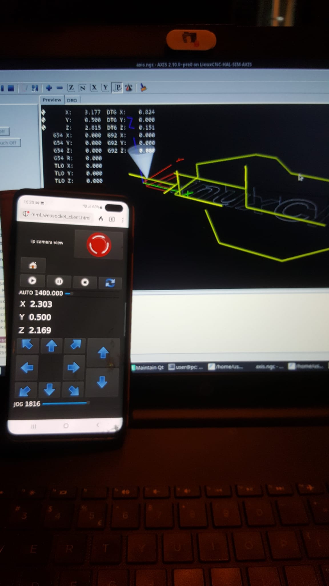

Ok i now have a mobile phone that interacts trough a webbrowser with the linuxcnc nml server.
I have modified the gui a little bit. Even the combined xy moves are working.
It's very responsive and stable.
Picture:
Video:
www.youtube.com/shorts/IDJHTxdfp6Y
Codeberg is updated with this version of code.
Thank you for everything.
