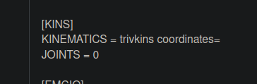

I m new to linxcnc and need some help. I have mesa 7i92TF and GEKO controller.
when i run the config i built - i got error below. how do i fix it ? Please advice - Thanks
Can not find -sec TRAJ -var COORDINATES -num 1

Please post your ini file.

[KINS]
KINEMATICS = trivkins coordinates=
JOINTS = 0

[TRAJ]
COORDINATES =

[KINS]
JOINTS = 0

[TRAJ]
COORDINATES =

Did you use the 'PNCConf' tool to create that config?

yes i do

Maybe the section about pncconf in this link helps:
embeddedtronicsblog.wordpress.com/2022/06/26/linuxcnc-setup/
